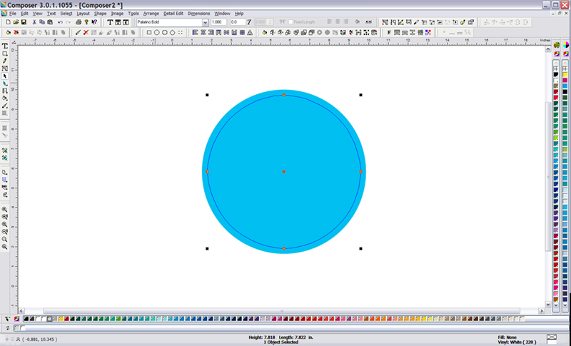

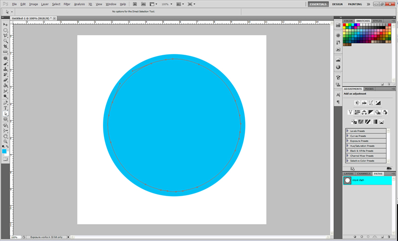

I think you issue rests with the software you are using to receive the file for production. For example, did you know that a flattened JPG saved from Photoshop will have any workpaths in it still present?
Here's a circle filled from a selection in Photoshop. The selection was then modified by contracting it and then converting that selection into a workpath. The JPG file was then saved.
Next I open the JPG in Omega Composer version 3 (a couple of years out of date) and it asks me what I want to do about the workpath. I tell it Okay and the workpath in the JPG file is brought in as a clipping path. From there I can leave it alone or release the clipping path and use it is a contour cut path in Omega.
The same might work with your software as well.

Interesting, I'll give it a try.
