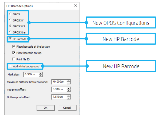

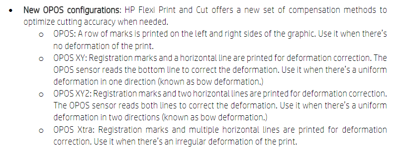

At least HP claims you still have all these options to choose from for HP Cutter PLUS (touch screen).
OPOS should give you the marks only.
