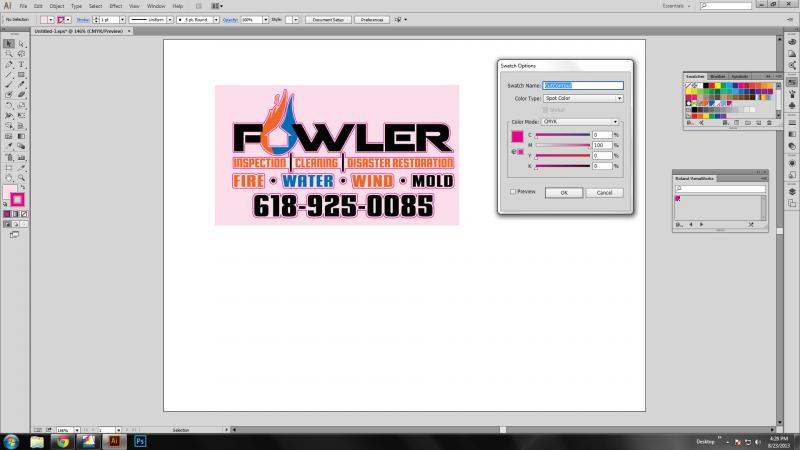

I've tried .EPS and .PDF in all legacy formats from Illustrator 10 to Illustrator CS6. The cut line is a vector and I have used the proper swatch. When I open a clean document and just create a cut contour, VersaWorks won't recognize that either. It won't even show or print a magenta line where the cut should be.

Yes. It is the CutContour swatch that was included with my copy of VersaWorks. Spot color, 100% magenta, named "CutContour" (both Cs capital, no space).

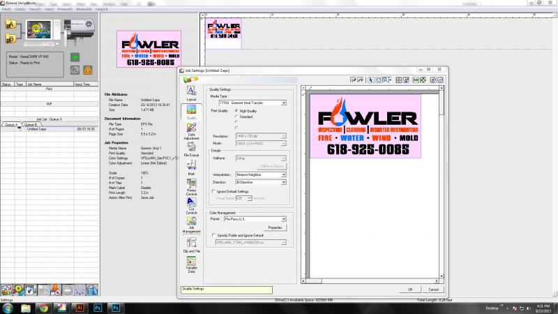

Here are screenshots for posterity's sake. They show the file in Illustrator and in VersaWorks. As you can see, VW simply ignores my contour.

And I just realized it's not recognizing any of my spot colors as such. Normally when I go into the File Format tab I can tell it how to output spot colors, or what to substitute them with... but here my options are grayed out and I can't change them. Maybe that's another symptom of the mystery issue?
I wish I could be more helpful with the details. I got kind thrown at this job, and there's nobody else here that knows... well, anything about it. No notes or production standards from the previous sign makers or anything.
