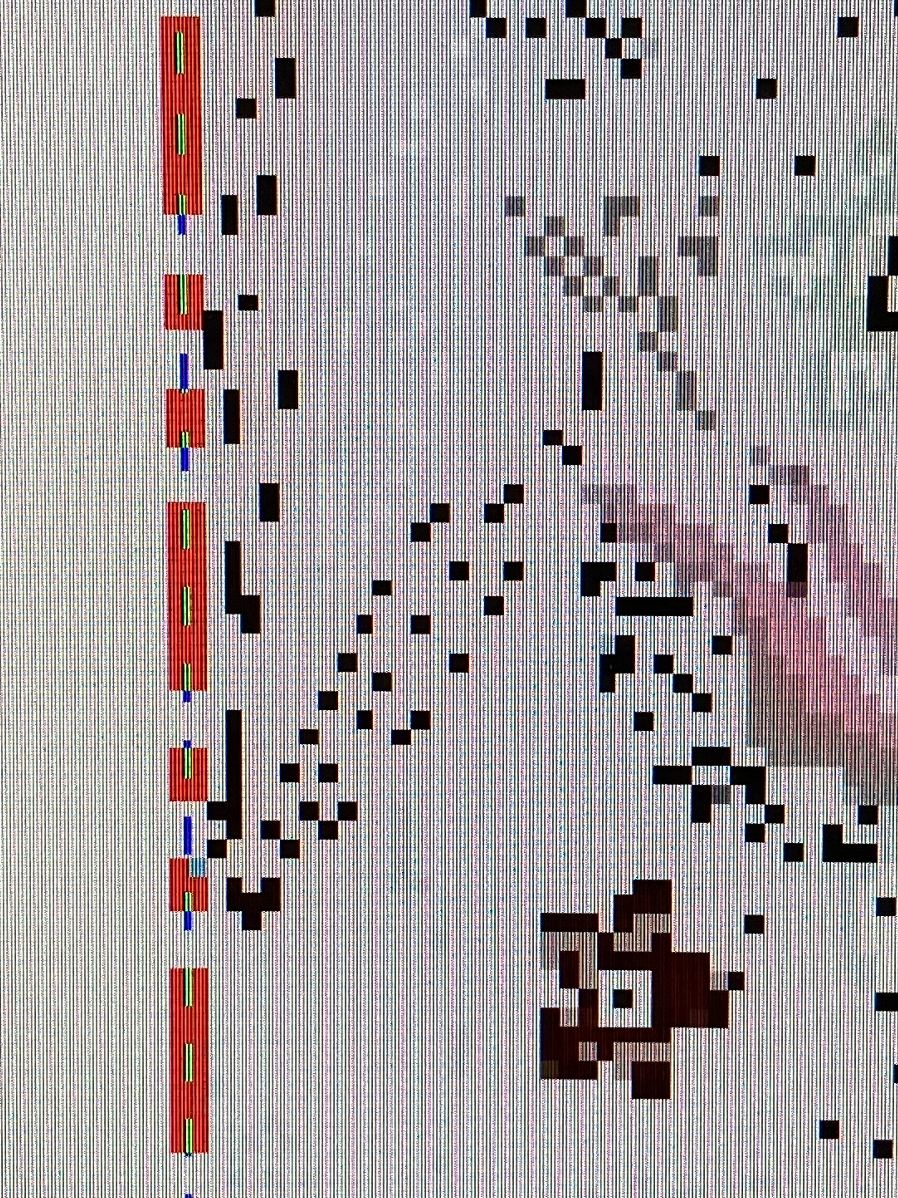

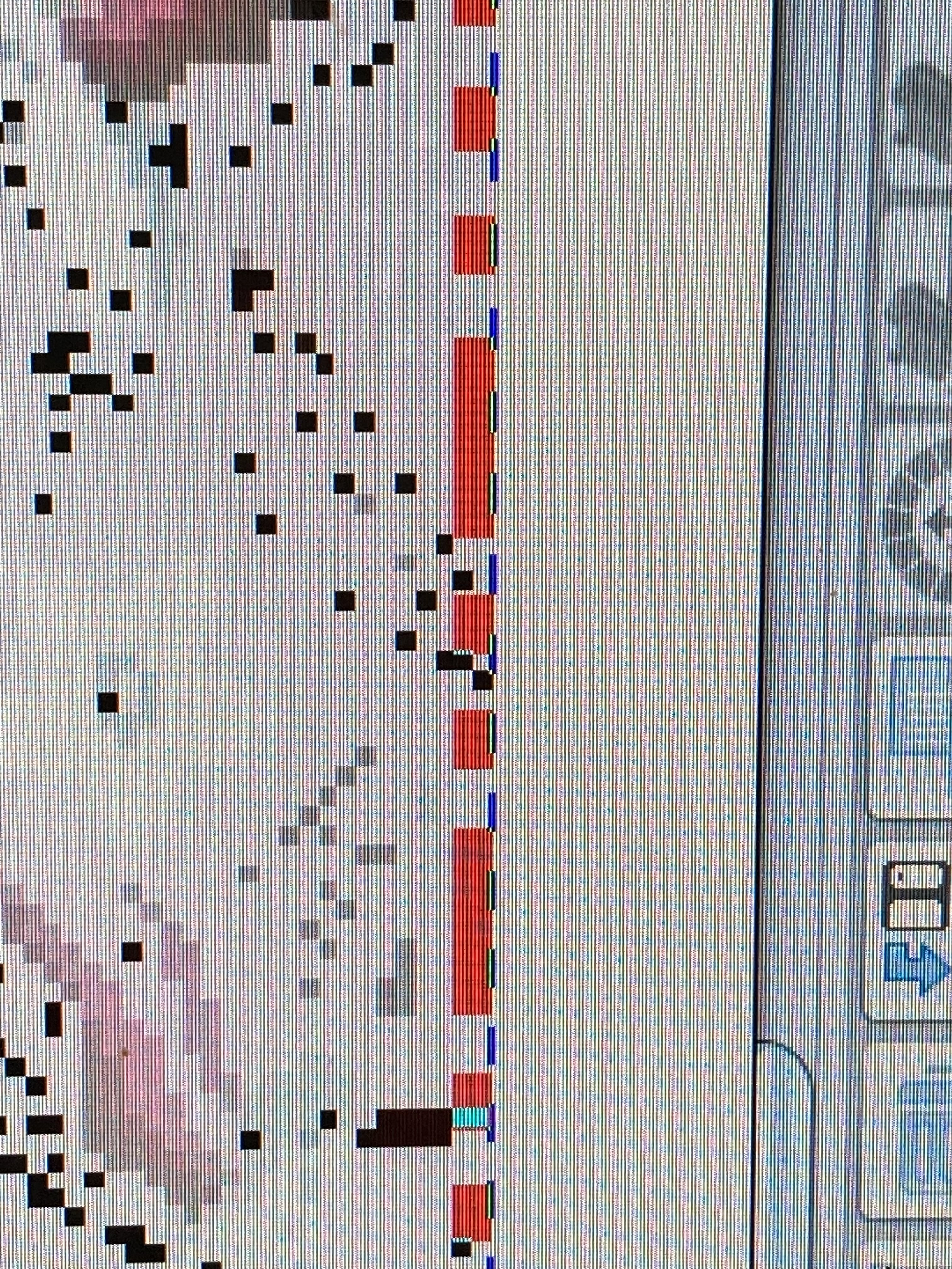

Firstly happy New Year everyone I hope you have a peaceful and healthy year. Secondly would anyone be able to advise me how I can edit the cut line as shown in the images attached in raster link as you can see it’s out on the right hand side so when it cuts it’s obviously out but I’m struggling on how to adjust it in Raster link that’s if you even Can adjust it in Raster link in the cut edit section.

Rasterlink's preview is not usually a 100% accurate representation of what's going to print and cut. It's more just for layout purposes. But it sounds like you're actually printing and cutting it and the cut is off? I'd start by running the print/cut alignment. You can download the user manual here. Go to page 100 for instructions on the print/cut alignment when not using registration marks. Go to page 101 if you are using registration marks.
That will at least rule out the alignment. if it continues to cut off after that, it could be a layout issue or maybe a file issue.
