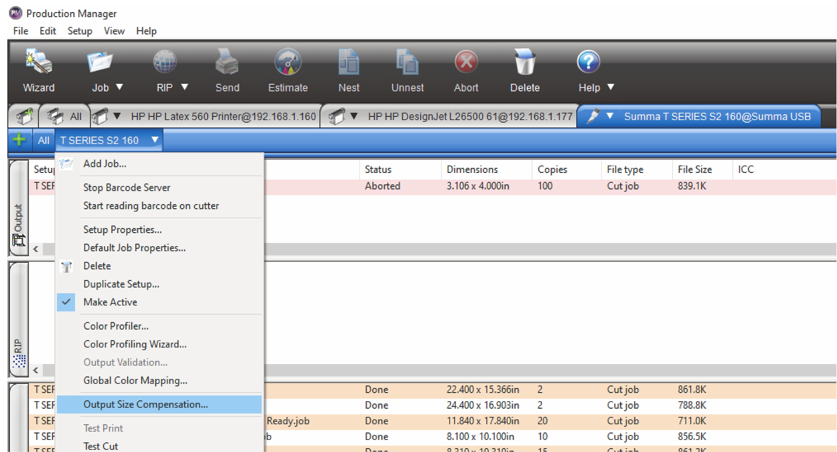

eahicks
You need to run Output Size Compensation....assuming you run Flexi. Not sure what other programs call it.
eahicks
