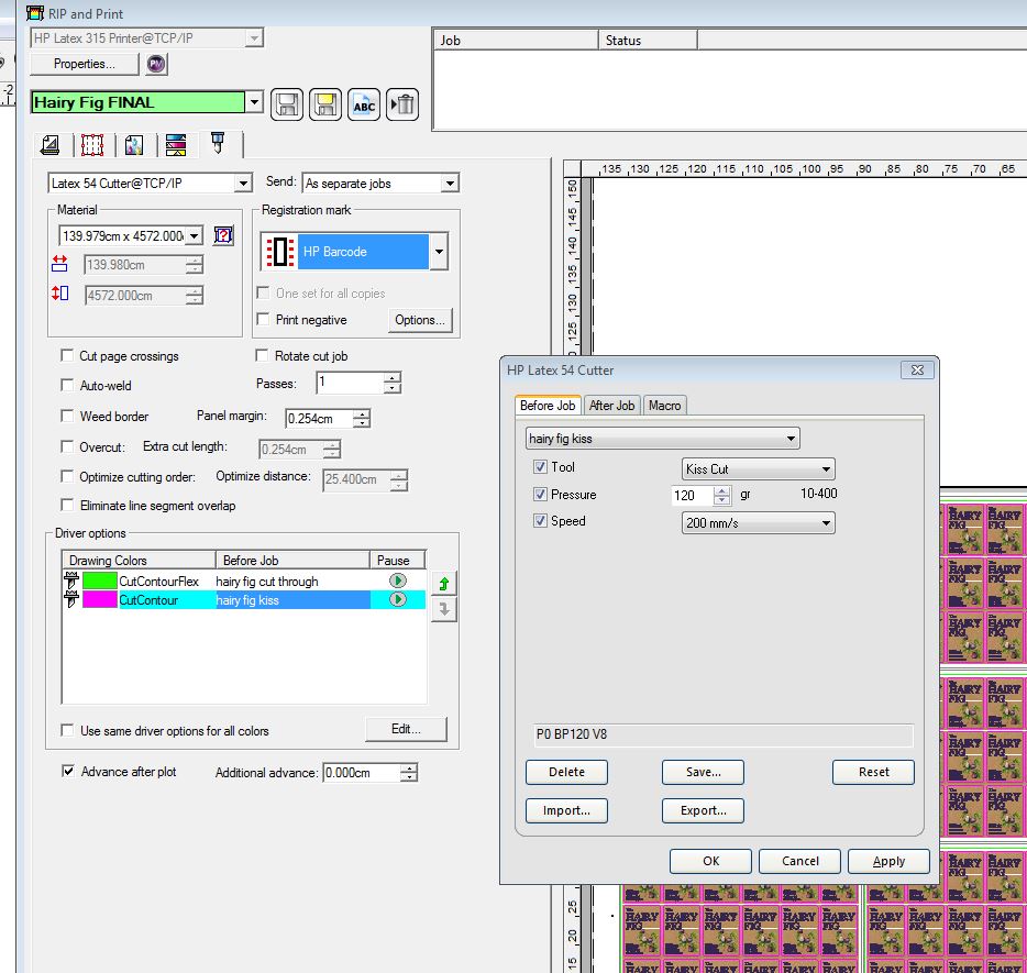

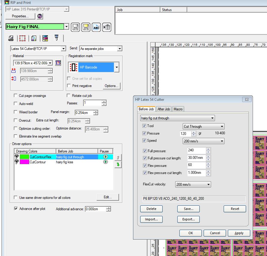

I have laminated graphics that I am now ready to cut. I have been trying all different kinds of settings on scrap laminated vinyl. I want to do a regular contour cut and then a perf-Cut. I have not been able to figure out the settings in Flexi to do this. Does anyone have any settings that they use to do what I want?
john maughan
these are the settings i use, but its just standard SAV, you will have to up the contour cut setting a bit to get it to cut right through.
