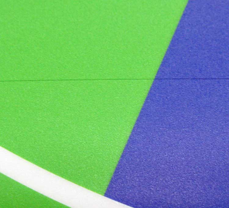

Oddly I've not had to deal with contour cutting extra thick stuff in a year or so and had to do some vinyl laminated with some heavy polycabonate laminate on it today and ran into the exact same issue on my Summa. Nothing to do with the cutter really - as soon as it started measuring the material and I heard the knfie dragging across and ruining one of the first prints I knew what was happening. :doh: Stopped it - put tables in front and behind the machine to support the material flat and ran on with no problems.
