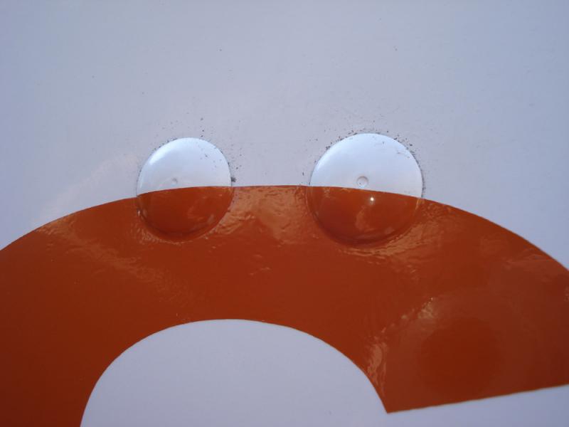

All i have ever done is apply the vinyl, tear the application tape off, where the tent is around the rivet just poke a few holes and use a heat gun to go inward with the squeegee all around it. Make sure you are using CAST vinyl.
