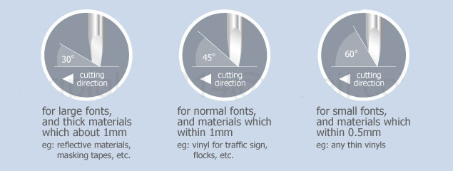

Look at the attached pic...
As a newbie wanting to cut thick material I could have been tricked in the opposite direction and bought a 30° blade instead of a 60°
(my 45° blade with max pressure barely cuts through the material, backing not even dented so I really need a better blade)
