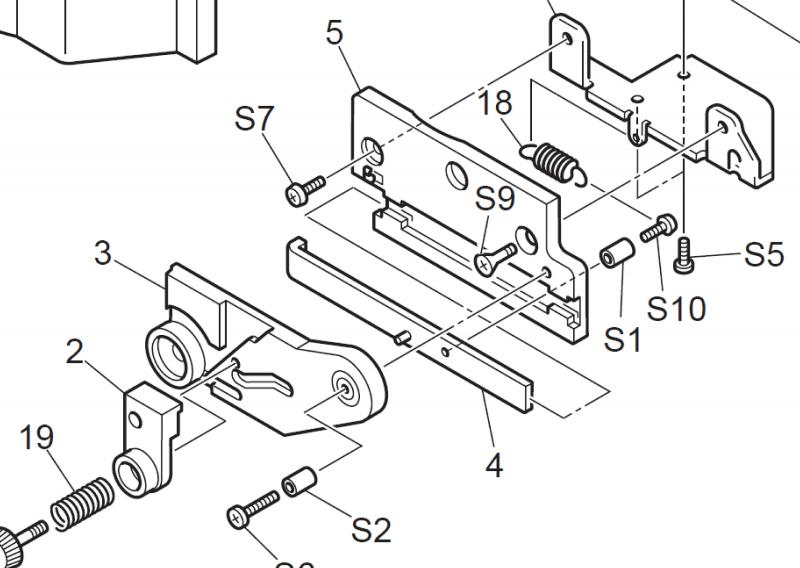

There is small spring in the mechanism that may have popped of...

Thanks for the help! Actually both answers were correct. I put a few drops of oil in there, and wokred it back and forth by hand a bit, then saw a wad of fibers and ink that was gumming the mechanism up. I gently pulled that out with tweezers. So that's gone, but now I can see the end of the spring dangling. I don't particularly like the idea of unscrewing parts there to get to it, but it seems like it would be a pretty expensive service call to do that simple fix.
Any thing to be especially cautious of if I try to take it apart?
mikeinpdx
Got it fixed. Just needed to remove screws s7 and s9, and the whole assembly comes off. Definitely a lot of dried ink and fibers on the spring, I'm not surprised it catches a lot of debris.
