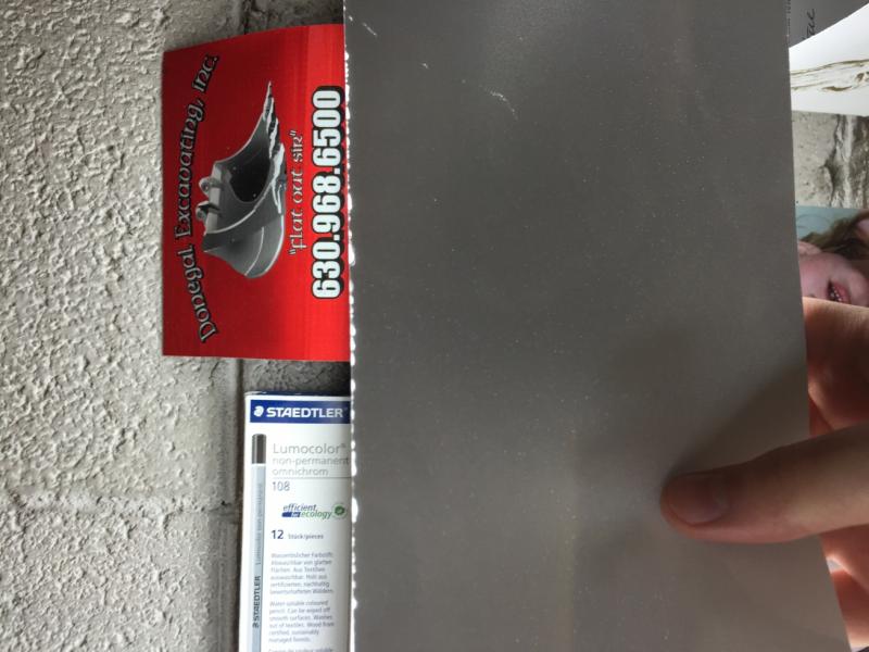

Hello everyone, it has been a while since I have been on the forum! Anyway, I just spent the last 10 minutes searching here for an answer I couldn't find. Here is the issue, we have been digitally printing on 680CR and laminating with 8518, however, when cutting, we notice that there is glue residue left attached to the decal that has been cut. It is very strange. It is completely random. While it doesn't trash the print or anything, it makes weeding it a nightmare. Whenever it leaves the glue behind, we have to go back by hand with an x-acto to remove the residue.
It is being cut on a Mimaki CJV30, 10cm/s and 250g pressure. Does it when blade is new or old. However, we don't have the issue with 3M 5100 media, which we normally use. Any help would be appreciated.
