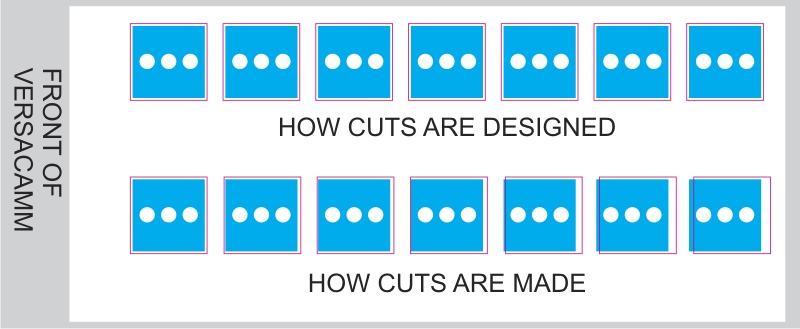

Cutting alignment issue - please see pic
B Snyder
Designed in Corel, exported as .eps. Using VersaWorks and VP-540. Same way I've print/cut millions of decals in the past.
The cutting begins at the right most decal where the cut is off the most and works its way to the left most decal where the cut is made perfectly.

B Snyder
Got me. I've tried 3 times and tried complete shut down of the machine between.
I should include, this is a print/lam/cut job.
oksigns
yeah if seen as length wise, J Hill is right that it is feed calibration that is off since it becomes inaccurate over the length of the print.

not sure it's relevant in your case but the pinch rollers can get caked up over time and cause slipping especially on long runs with heavy stock like reflective. Does sound like a media feed issue though. Some plotters have adjustable pinch rollers and they all have be set to the same pressure.

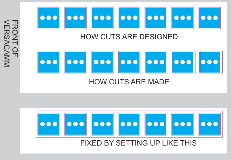

I have it working well again. (See pic). Not sure why the machine likes it better this way but it works.
I actually have these printing 70-up, fitting an 8.5x11 area.
Thanks!
