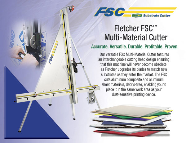

We used to cut it by hand, with a 9mm utility knife and a straight edge. Just takes a sharp blade(s) and a lot of passes. Then we got a fletcher wall cutter and it's awesome. For UV prints on the flatbed, we precut the ACM before printing - found that cutting after printing can cause the ink to flake and chip on the edges.
Get one of these:

Get one of these:
Exactly what I was talking about.

Assuming the FSC is also a pair of pizza wheels, might be worth a shot. Some of the Baryta papers we use will shatter as soon as you look at them, or cut too quickly, blade is a touch dull, type of monsters. On the SteelTrak, we have production stops, and the ruler properly dialed in, so setting a 3mm bleed is doable, but not fun.

It comes with different blade types for different substrates. The ACM cutter is a wheel.

you should call fletcher. they have quite a list of different cutting heads for these
