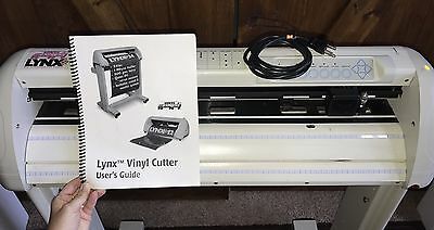

I was recently given an old Lynx 24" cutter. It's a real antique. Looks similar to the one in the photo that I attached.
