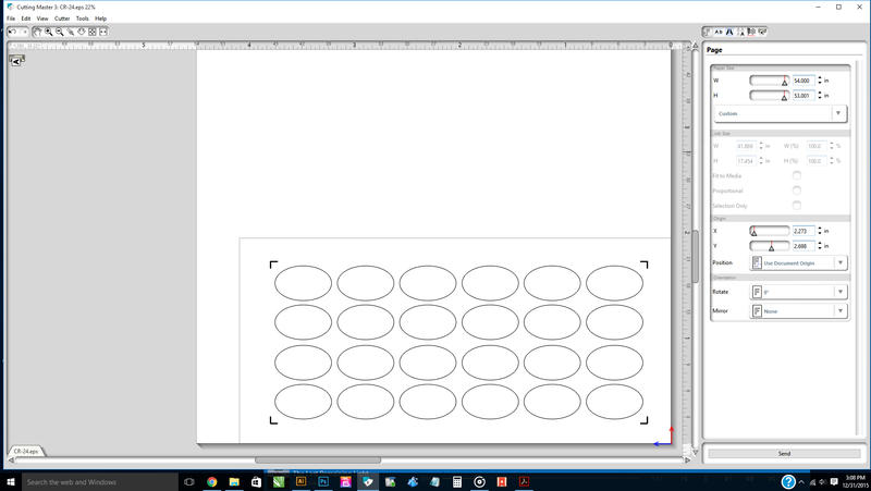

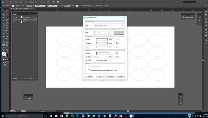

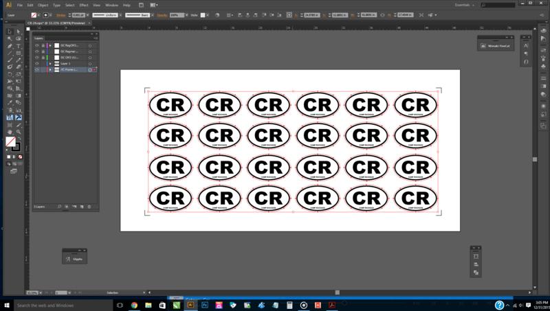

I'm new here and new to this business. I'm having an issue with my Graphtec FC8600, particularly with cutting a full sheet (54") of decals/stickers. I've attached some screenshots of what I'm doing, and the end result.
1. my offset in Illustrator from FineCut 8
2. inserting reg. marks with Cutting Master 3
3. how it looks in Cutting Master 3
4. the offset here represents how the cutter actually cuts it.
The cutter seems to work with all other cutting jobs, just anything with a lot of objects on a large sheet doesn't line up. The material is loaded straight and aligned in the cutter
I'm assuming the procedure in thread (http://www.signs101.com/forums/showthread.php?129111-Plotter-Question-Skewed) would probably do the trick, just wanted to check if there was anything else
I might need to know in getting this worked out.
Thanks for any help!

Dennis422
Where did you buy your cutter?
Contact them and they should help you with resetting it and with uploading the new firmware. (If not up to date)
I had the same issue, and when I talked to Grimco, they helped me with the issues and since then is running fine.
basstrax
Thanks Dennis!
I was able to update the firmware and make ARMS adjustments using scan test sheet provided by Jburns!
Definitely made an improvement!!
