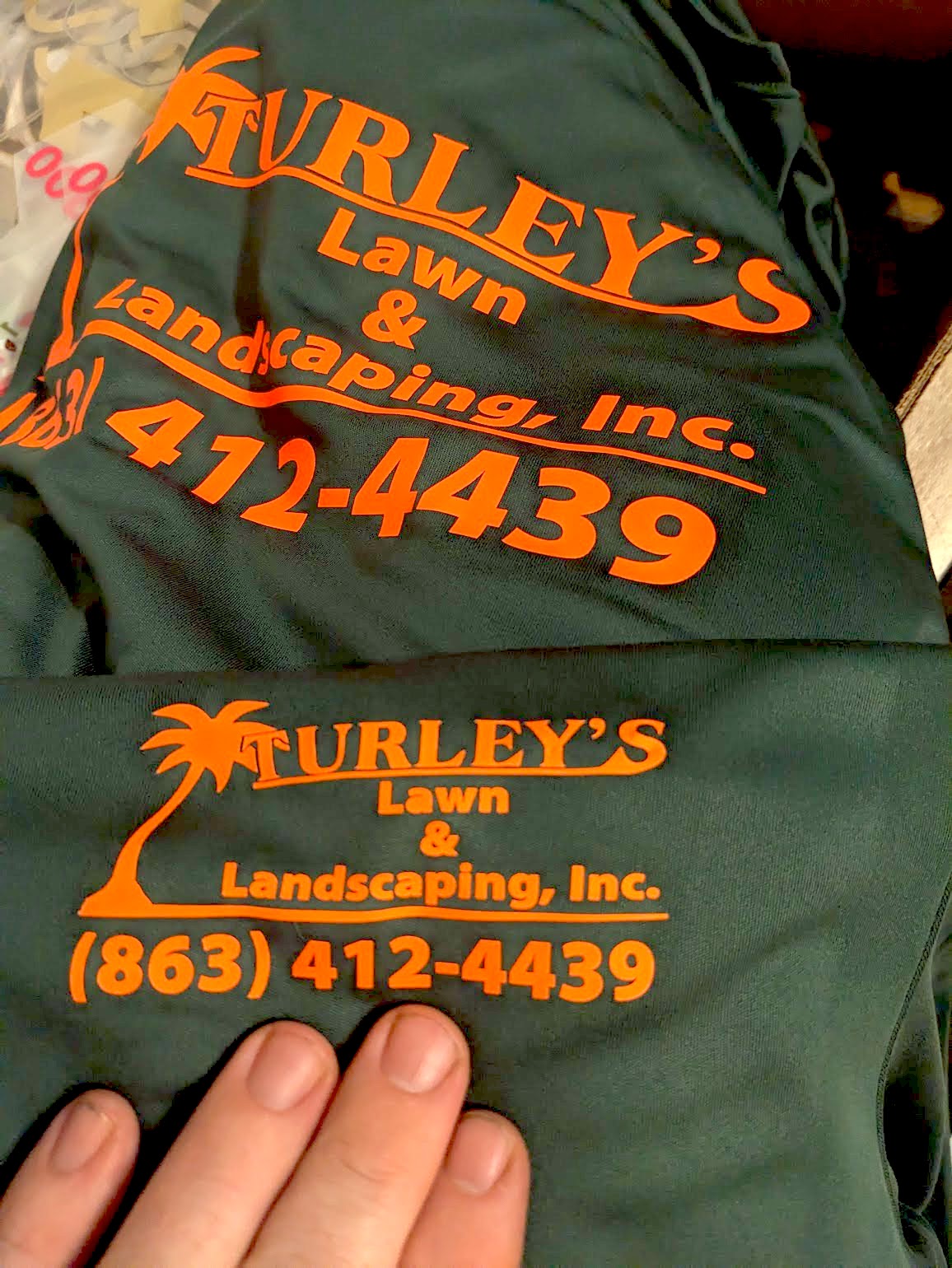

you need to work on your settings or find a different material. I regularly cut HTV MUCH smaller than that with my Graphtec CE7000
Example, the capital "L" in "Lawn" is .21" high on these shirts

ToneCustomSigns
Are you using a printable heat transfer or a cut heat transfer? I do both depending on the artwork. I have a hard time weeding the printable heat transfer so I try and avoid text with that material whenever possible.
However, the cut HTV comes with a sticky back liner that holds the vinyl in place very well. You shouldn't have any issues cutting .75 or .2 for that matter. I would check the offset on your plotter. If the letters aren't cutting correctly, that will make it difficult to weed. Also, test the pressure. I have a Mimaki CG-130 (ol' reliable) and I use a 45 degree blade with 20 pressure and 5 speed. Hope this helps!
