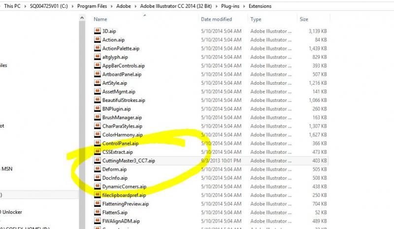

cutting master.jpg It works but you have to drag the cutting master .aip into your plug-ins extensions folder
hjc
Where would one find this file .
Currently running cc2015. Installed cuttingmaster 3 had no luck locating that particular file . Please help
