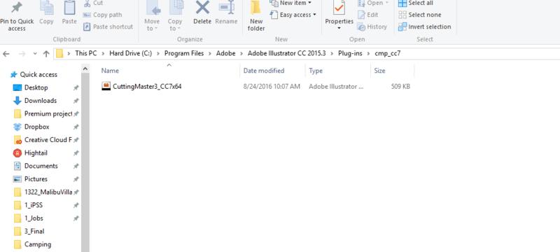

JoeBoomer
Fixed!
Thanks Sean!
Move the folder "cmp_cc7" w/ the file "CuttingMaster3_CC7x64.aip" in it to the new "Plugins" folder for Illustrator. (See below and the attached image)
"C:\Program Files\Adobe\Adobe Illustrator CC 2015.3\Plug-ins\cmp_cc7"
Go Team!
