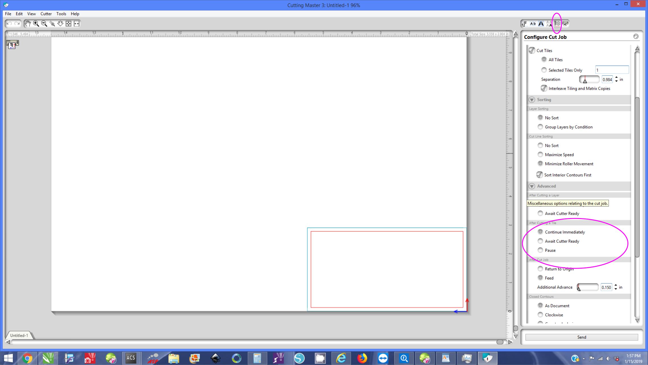

I got a new Graphitec CE6000 cutter to replace my 18-year-old CE3000 and the new cutter will not work with the old Cutting Master 2 so installed Cutting Master 3.My question is when I send a job to the cutter that is 4 columns wide and 3 rows high, it only cuts the first row and then stops and say "PAUSED", and I have to manually select CONTINUE for it to continue cutting, but then it pauses again after cutting the second row.
Do you know how to turn off the pause so it will cut all 12 decals without stopping?
Thanks for any help.
JulieS
Under "Configure Cut Job" / "Advanced" / "After Cutting a Tile", click on "Continue Immediately." This is all on the right side of the screen.
