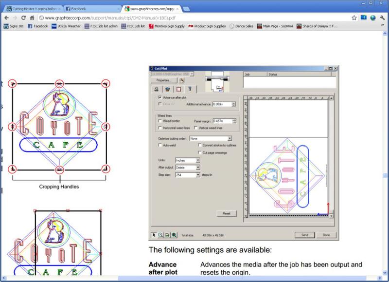

reading the CM2 user manual, there is a optimize cutting order feature in the advanced plot dialogue...
Optimize
cutting order
Select the order in which objects in the design will be
cut:
None The objects are cut or plot in the order
they were created.
Speed
Priority
The objects will be cut in an order that
maximizes cutting speed.
Restrict
Media
Movement
The objects will be cut in an order than
minimizes the amount that the media has
to move.

I have read the same thing, but that setting seams to make no difference in going from one set to the next. That setting seams to only affect what is in the set of registration marks.
