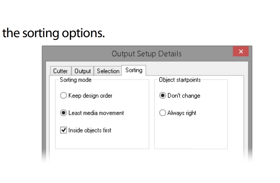

If you are or can use winplot in the mix...
You could try using sorting option that says something like "least media movement"
