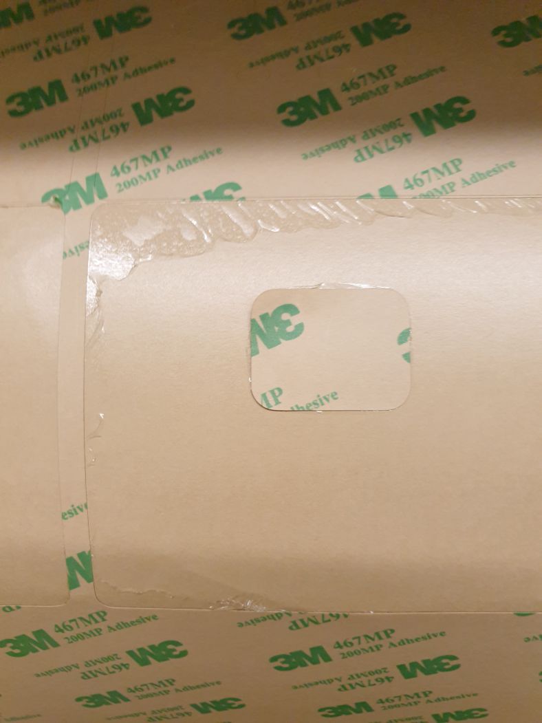

Hi.
I have a problem cutting shapes out of 3m adhesive transfer paper. My machine (MImaki CJV130-150) cuts the front and even the back carrier, but unfortunately the adhesive itself is not cut, therefore when I peel off the shape or the internal holes, the adhesive remains on the rear carrier. I am asking for help or any tips on how to fight it.

I am not really sure what do you mean by actual material, this adhesive is like three layered "thing": backing carrier then glue then paper.
Problem is with glue which is sticking back after cut.
I was playing with lots of settings like weight/pressure etc. and nothing helped.
I remember our old machine Roland never had such a problem.
I will try with number of cuts as you mentioned, maybe that will help. Thanks for pointing this out.

we usually die cut our adhesive because that's what our applications require but we have done this on our plotter (roland) for small qty's. based on what you are showing could be a few things.
first not cutting deep enough, blade cutting too fast and getting the adhesive bunched up and the blade will hop leaving uncut areas or possibly a dull blade.
shemeck
Hi there, I was trying 30, 45, 60 degree blades.
Any way thanks all of you for help.
After fighting, the only way which seems to work is to put blade ridiculously far away from holder, it's cutting almost thru material but at least glue is not stuck back.
