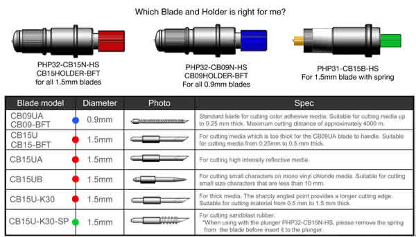

I am trying to make some decals for gas pump control. I am using 3M IJ white printed decals and then laminating them with a thick 10 Mil Polycarbonate lamination. I am trying to cut through it with a Graphtec FC7000-130 plotter but I not getting very good results. I have tried using the 60 degree plotter blades and I got it to work for a short time but then the blade broke and the next two I tried the blade broke in that as well. Has anyone done/tried this before or does anyone have any suggestions? Thanks.
John in Cali
The CB15U blade will work with the red top blade holder.

Awesome thanks for the help!!, The new Holder and Blades helped as well as making it a 2 pass cut, now my next issue, the material is quite rigid and it bows a little bit. When the plotter head is traveling between cuts the blade actually scrapes the top layer of laminate and scratches it and its pretty noticeable. I have a Graphtec FC7000-130 I have the fan power the highest, and the blade almost as far as it can go in the holder. Any Suggestions to fix this issue?
