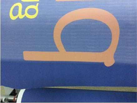

I am having a problem with my cyan dropping out of my Mutoh ValueJet 1640 once another color is introduced to the print. Does anyone have any ideas on how to fix this problem? It is happening on 2 of my printers, but not on the other two? We have already tried changing to a new batch of ink. Humidity is 45%. Replaced dampers. This only happens with cyan, and always when it gets to a different color.

Sorry, new to the forum. Attached is the photo. After it drops out the left nozzle check is gone and the right is completely there. Bulk Ink. Head was replaced beginning of Feb, and I am not sure how old the maintenance station is.

That did not work. Still dropping out right when a different color is introduced. Same spot, every time. It can however print 40 feet of pure cyan with no problem, but once it comes to a "logo" or a different color, it [cyan] drops out.

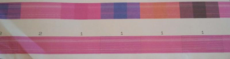

Mutoh RH II One color drop-out
I have some problem for one head in RH II 64. When I check noozle, magenta droping out with all noozles, this problem still here with me. When I replace another head into this position ( head C/M) that print normaly, I think, problem is on head. Now I wait for new Manifold for replace old and test head. I can't print, only when I discontinouted magenta ink. Please, Help me!!!

All 4 machines run from the same computer but I have two different rips. And I can print 1m and then a color and it drops out, but I can also print 50m then a different color and it drops out. It is only dropping out when a new color is introduced. And that color could be "white" or no color, and it still does the same thing.
