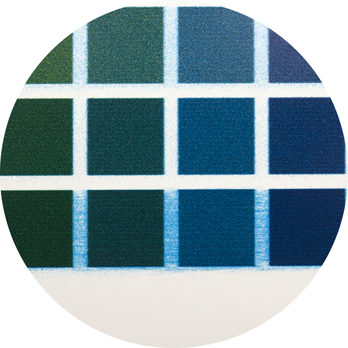

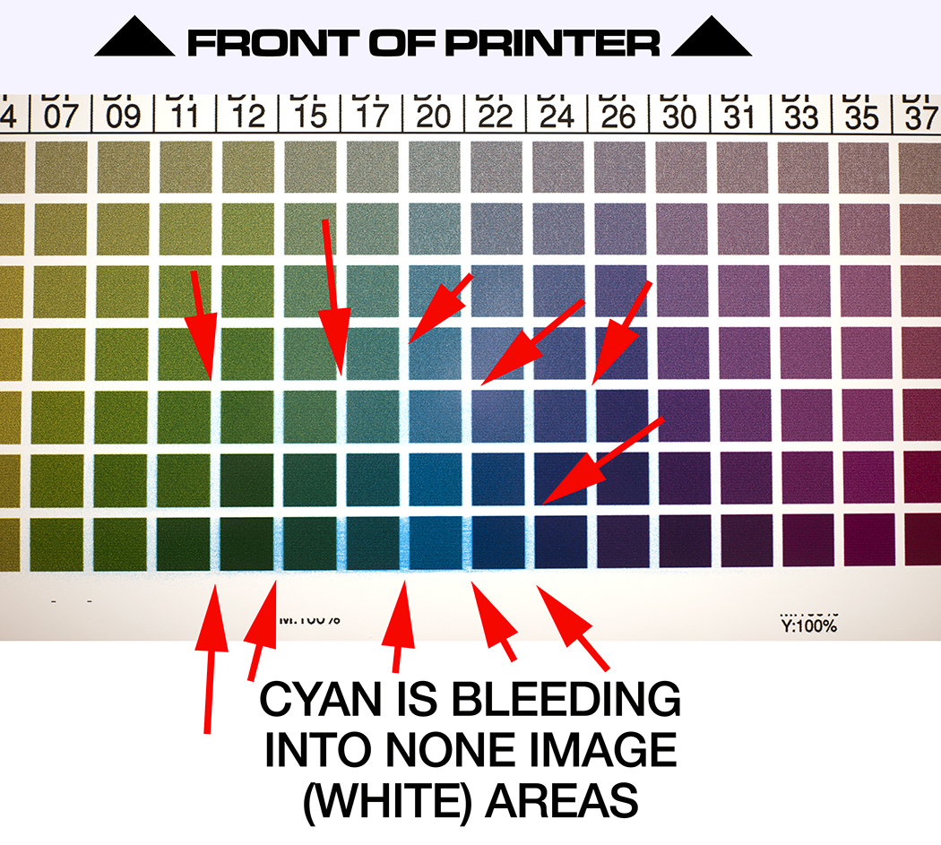

I have a Roland SP540V and it has been printing very well and then all of the sudden today it started to MIST (spray or bleed), cyan ink into NON-IMAGE areas (white space). See attached photo.
Anyone ever seen this or had it happen?
What would cause this?
I just did a maintenance cleaning and don't see anything on the CYAN head.
When I print a job with NO BLUE, it prints ok, seams to only happen when the head goes across a blue part of the image.
