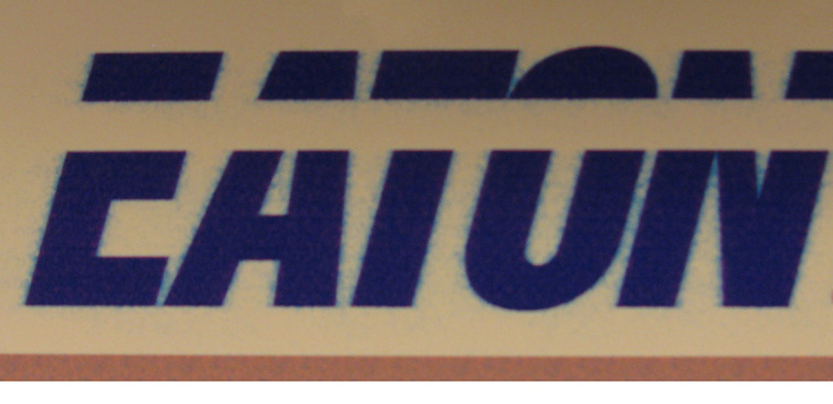

If this is not a static issue is it definetly the print head being bad or is it possibly some type of calibration? It appears to primarily occur in the head travel direction and not the feed direction. It used to be really bad, spraying everywhere on the vinyl before and after the image, even on the printer before and after the vinyl. Thoroughly cleaned inside printer, print head ribbon cable & encoder strip which seemed to cure the problem but only temporarily apparently.

Id check your bi-directional and feed calibration first. But this looks pretty bad, when was the machine serviced last? What type of printer is it?
Sign Works
Roland SP-300V, light use, eight years old, no service except for when the pump was replaced at one year old, maintence - regular head cleaning, wiper and captop replacements.

Nope, only started recently. Dampers look OK, don't know about checking the head rank, guess it's time to get the tech out here to go through this thing completely, probably time for that cyan/blk print head it's needed for years.

Just realized that I never followed up on this thread. So here goes in case it might help someone else in the future.
1.) Replaced dampers and captops then performed all printhead alignments and calibrations.
Results = No change
2.) Replaced K/C printhead and performed all printhead alignments and calibrations.
Results = Printer prints like new
Got the printhead from one of our board merchants solventinkjet.com for $795
So nice to be rid of the cyan misting and no more deflected black nozzles also.:thumb:
