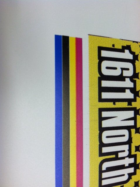

We replaced the fuse and got the black printing now so everything is printing. Now our problem is getting everything lined back up again for some reason. In the book we got it lined up like it showed but the black is off from left to right. Is there a way to line that up?
yamaha581
Here is a picture of what were trying to fix. As you can see the colors aren't even with the black lines. Would you know how to fix this. We tried doing what it said in the book but it wouldn't do anything.

CRD
page 129
then
Step 15 to 18 on page 161 of the service manual.
Try large values to see what happens.

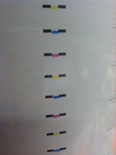

We got that set up good now I attached a picture of one we are guessing we need to fix as well. Would you have any idea how to adjust this?

CRD
Just follow all settings for adjustments from the manual so you havent skipped anything.

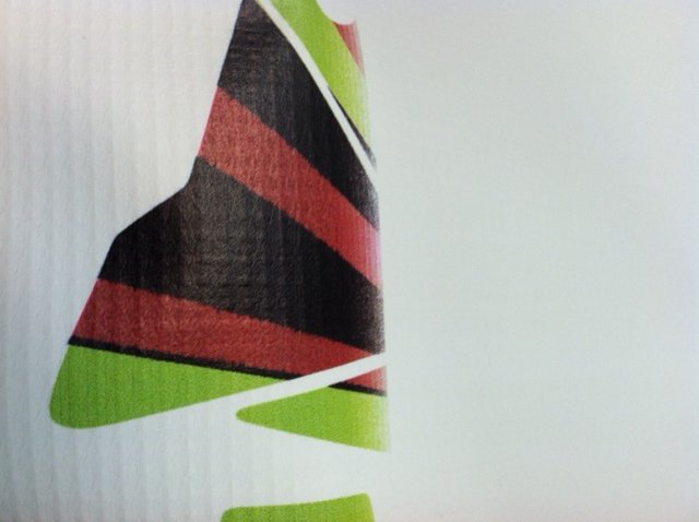

We just ran into another problem. We went to print and for some reason the colors were messed up. In the picture the dark red would usually be bright red and the green would be yellow. We took a look at the damper and somehow the yellow damper is green. Would you have any idea how this happened?

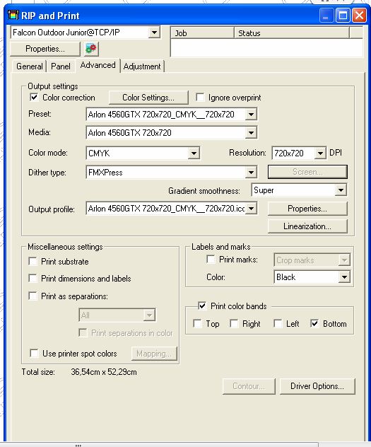

We went ahead and changed the setting in Flexi. Were also trying to pull ink through the capping station and for some reason its not coming through now.
I also had another question when we go to the rip/print it opens up and a box comes up and says
"some of the color settings are different from those in production manager. override them with those in production manager?
Would we want to say yes or no to that.
CRD
Try to pull ink from the yellow damper exit. If it does not then the vacum pulled the cyan ink from the cappingstation into the damper.
Try to distinguish where the block is.
For the screen pop up. This tells you the current standard setting is changed and if you like to use the new setting.
Standard settings can be done in the productionmanager.

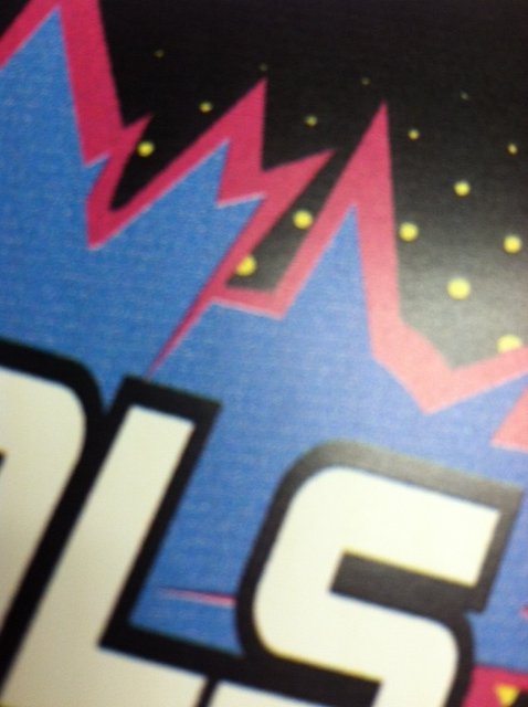

We got it all printing this time and hopefully it stays that way lol. Our only problem is just a small one now. I attached a picture of the cmyk that it prints at the beginning and a picture of the cyan that we had in our print. I know the cyan in the beginning is going to be darker than the print. The only problem we have is that the cyan has banding. Would this just be a profile issue?

CRD
With this machine in Cyan and Magenta banding is more Obvious then yellow!
Looks like the head alingment is still not 100%.
Between the cymk lines machine wide there should be no white inbetween.
Does it do it on all vinyl or just the Substance vinyl?
Take notice this is not a 3000+ dpi home inkjet printer.
It prints with 11 picoliter instead of the 1.5 picoliter drops of current Household inkjets.
720x720 dpi is good enough if you look from 50 cm distance the banding disappears.
