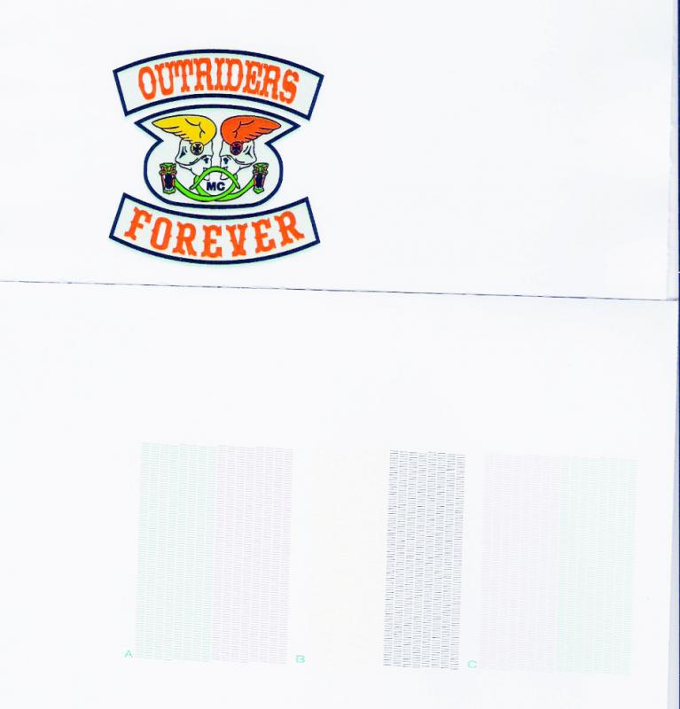

Does anyone have any idea what it could be, my test print seems to be fine
however to be honest i wouldn't know if it was bad.

hmmm. we spent a ton of cash chasing a similar problem on our mimaki and it just ended up being a bad lot of cyan ink. for a cheap starter, i'd switch in a new cartrige and do 4 ink fills to flush the lines and see if anyhting changes.
looks more like the printer head is in need of alignment i've had a similar problem when the head shifted realigned and it was fine granted it took several hours to do this
