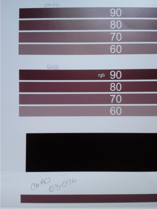

Tony McD
test print with the cmyk values 0-3-0-76 comes out about the same brownish.

splizaat
Wow... media/profile?
Is there any kind of mask over the top of the grey section? Or did you start a brand new file with just a grey stripe and print that for 0-3-0-76?
Tony McD
The 0 3 0 76 was a new page in corel x3 set to those cmyk values.
Cmyk and rgb files was also a new page.
The big black box is 100 % k.
This just started...printed greys fine Monday.
Also made the files in x6...printed the same brown.

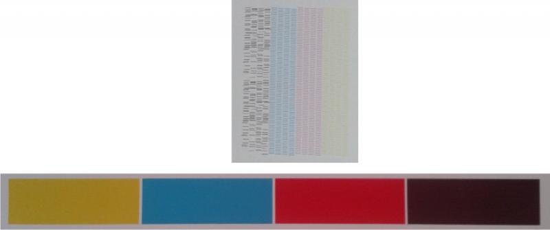

Here's a nozzle and test print of cmyk.
(not a good photo....cmy looks much smoother)
Clamped of the drain lines at the cap tops...filled with cleaning fluid and rested the heads on it overnight.
Didn't make any difference in the black.
I think maybe the black head is just shot.

Tony McD
I have tried several other things today with no luck.
The overnight head soak didn't seem to help much with the nonfiring nozzles.
I will do it again, and let them soak over the weekend, maybe that will help some.
One more question...
Is it possible the missing nozzles in my black printhead is causing my greys to be brownish?
Or is there another problem I haven't found the answer to yet?
