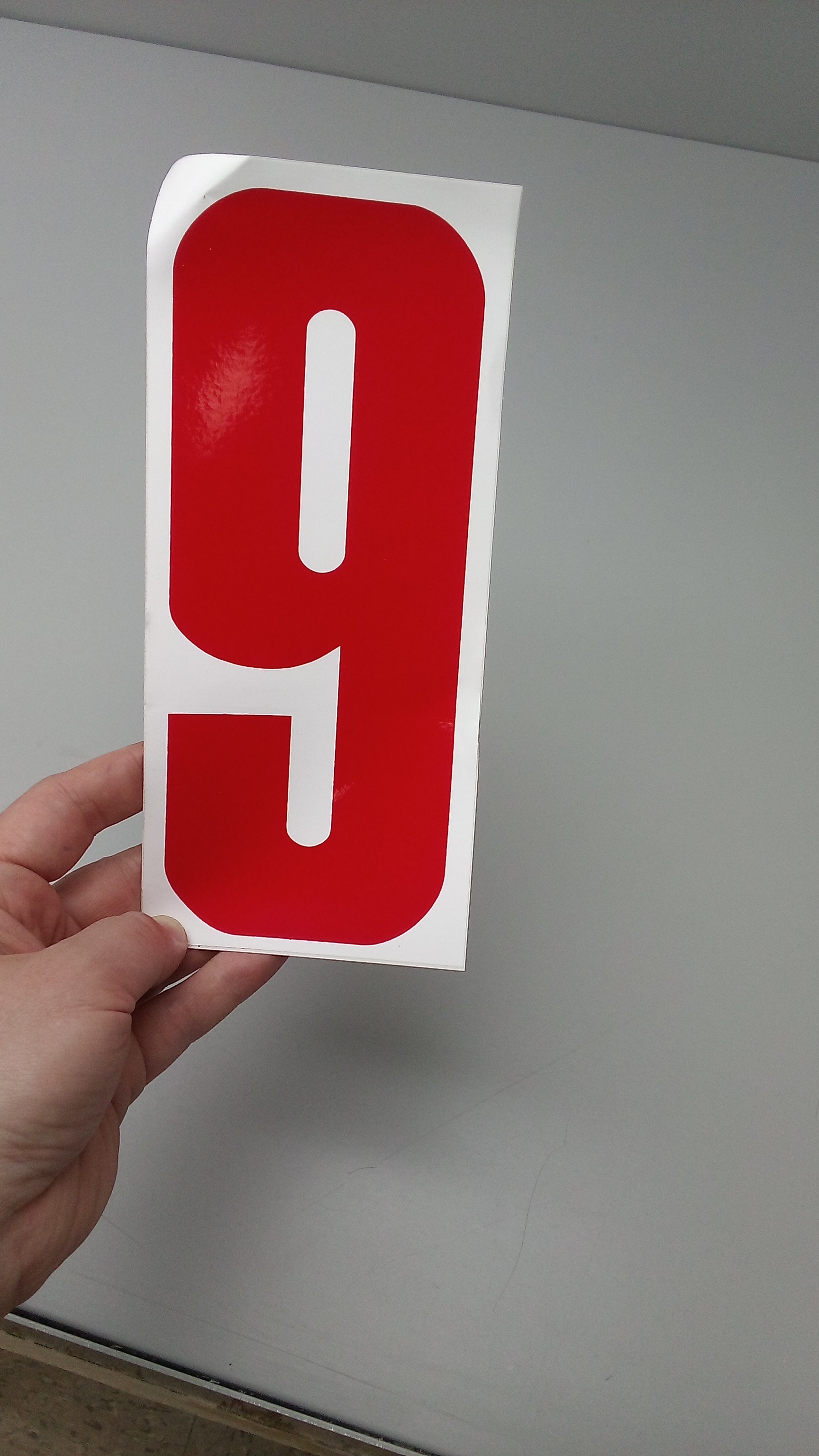

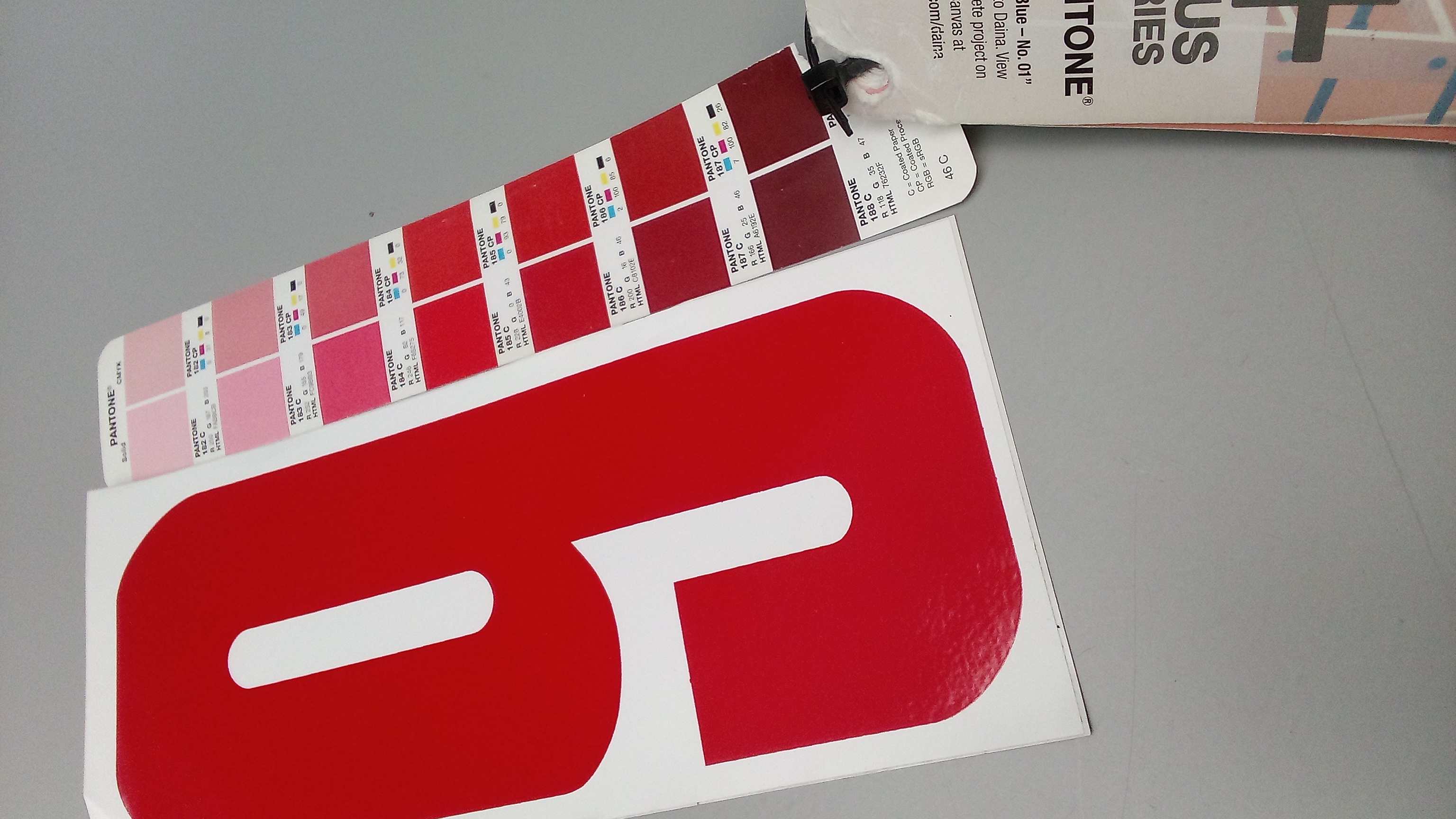

Do you have a reference for the target color (Pantone spot or physical specimen)?
Can you take a (well lit) pic of the two and post?
Tim Miller
Is the number (9/6) the reference color, or what you are getting from the Colorado? If the former, can you post the best red you are getting from the printer?

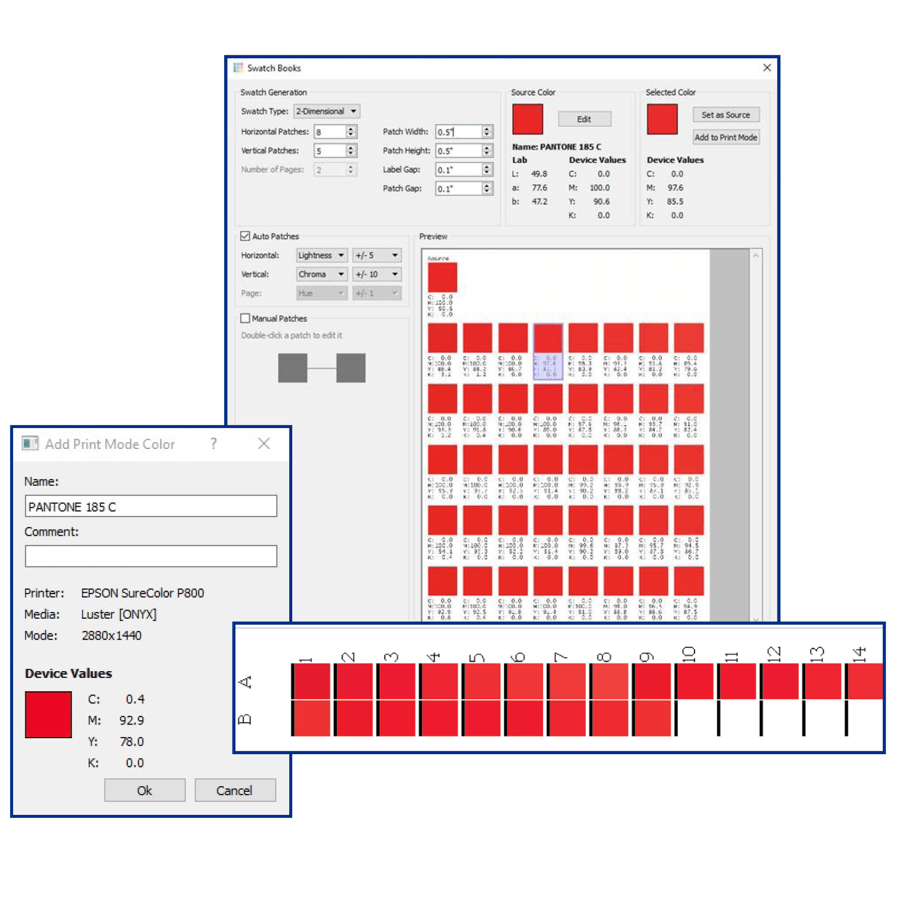

Specialty is going to be your best bet though and I agree with using the swatch book in Onyx. Then you don't have to make all your own swatches.
