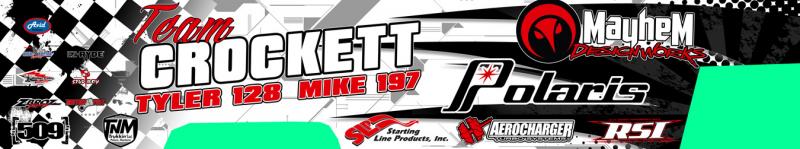

this is my first real big wrap design, it is going on a 43' trailer for some pro snowmobilers, i think it looks good but the bigger logos in the front seem a bit weird, just thought i may be able to get a little advise on what you would do to make things flow a bit better, thanks. the green parts are where the wheel wells are and where the front of the trailer is clipped. trailer 3.jpg
HulkSmash
You literally took about 11 stock photos and ghosted them into 1 another. It's literally unreadable, and the sponsors might not be happy with their logos lost in that check flag?
I think you can do better
Border
you could always try making the background colors/checker patterns translucent so that all the logos, names & numbers stand out better against it all.
xxaxx
Looks like you just threw up vecteezy all over the side of that thing. You can make it bold and "extreme" while still making everything legible. You completely lose all the small logos up front. The Team Crocket feels like an after-thought, it should really pop off the side but doesn't and the team font can't be easily read and gets lost in the flag graphic.
