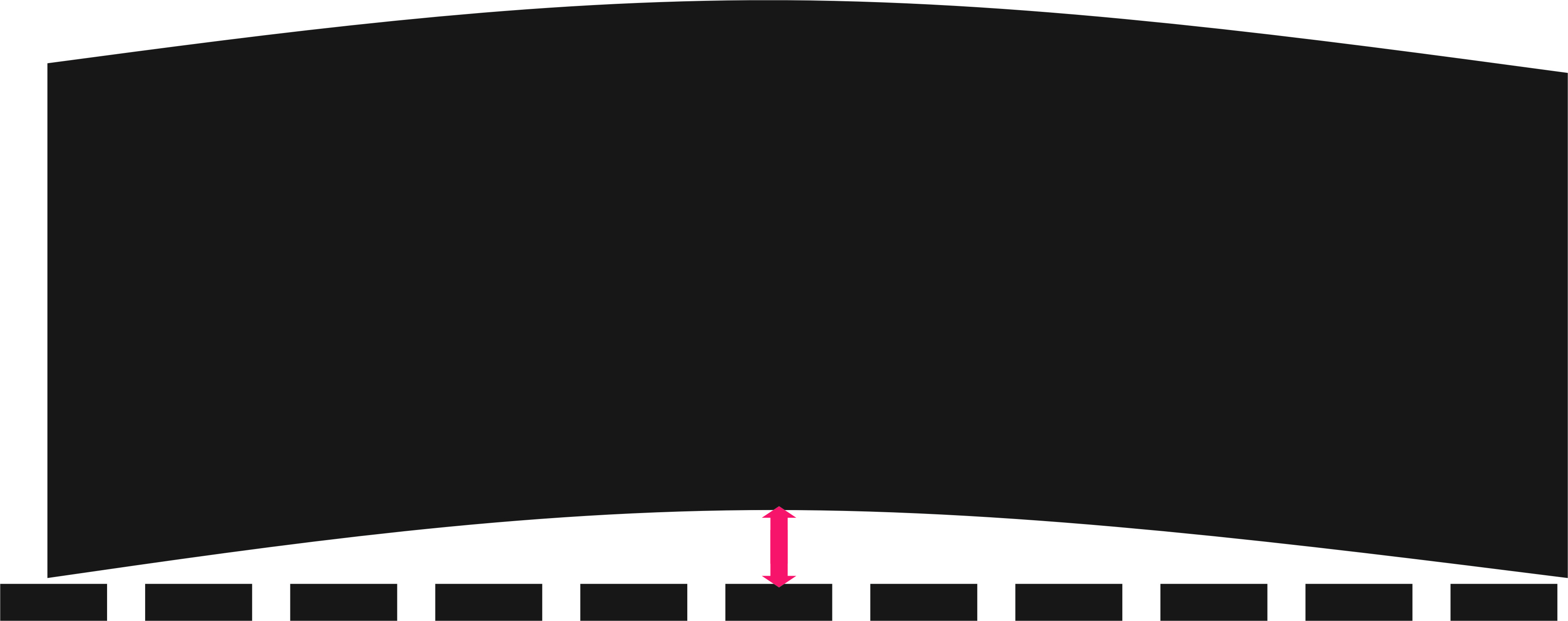

d fleming
Red arrow = amount of curve. Use a straight edge for baseline and a ruler to measure distance from base to window. My wife usually holds one end of tape measure for straight edge. Same applies to getting curve for windshield graphics .
