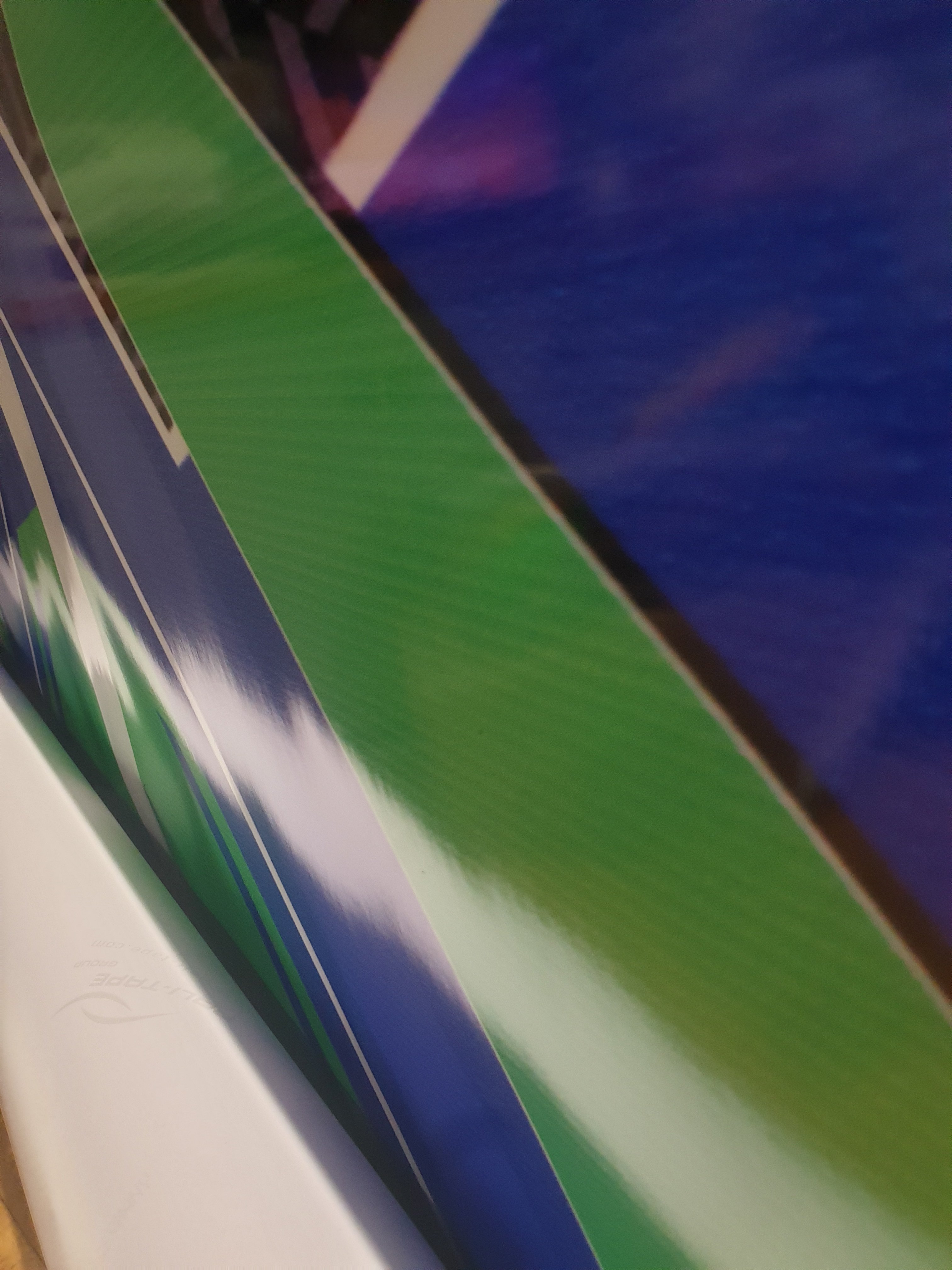

Hi i have resurrected a hp designjet 8000s for my own personal use can anyway tell me why it prints stripes like this. Thanks in advance

What does your nozzle check look like?
Head alignments done?
Uni- and bidirectional alignments done?
And last but not least, print feed adjust (step adjust) is extremely important for these machines. Has this been done?
Ere
Set print driver to high quality printing. Sounds silly but I have solved some HP inkjet problems this way.
