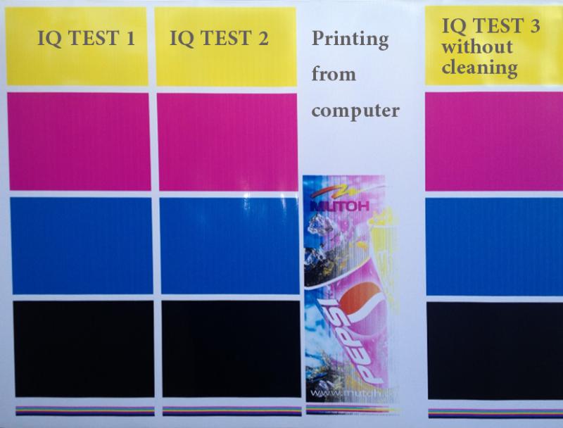

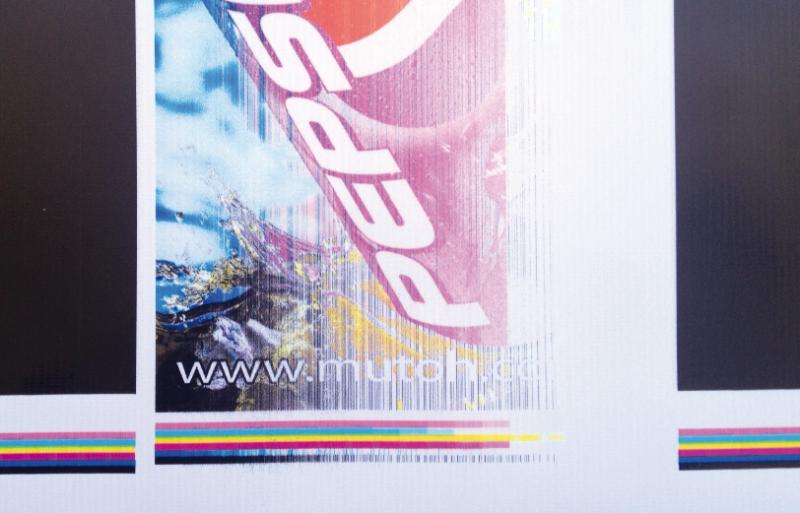

I have a very strange problem with my Designjet 9000, as soon as I start printing all printheads start to drop nozzles and soon it starts to print blank as if there is ink starvation, I cancel printing and run IQ test (without cleaning) and it comes out perfect, I repeat the IQ test for 5 or 6 times and still perfect, I start printing again and ink cuts out after less than 5 cm.
Replaced USB cable, replaced the RIP computer, used another RIP software and another computer still the problem exists.
Please note attached files.

I don't think this is the issue, as I can print IQ test (8 inches of solid color) 10 times continuously without any ink starvation, while I can't print 2 inches of halftone from any file. Please check attached files at the beginning of the post. By the way, I'm a SAM Ink user.
