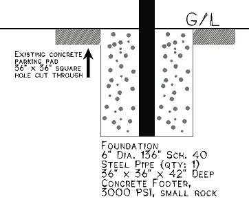

Customer has a slab parking lot, and new pole sign is going in.
We need a 36" x 36" hole cut through the slab, which customer will handle (supposedly).
How best to dig the following hole?
James Burke
Diamond saw the 36" square perimeter, grab a shovel and go for it. It's a bit precarious to dig it with a bucket, unless you know what you're doing.
