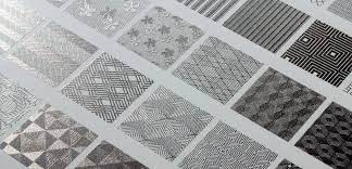

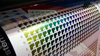

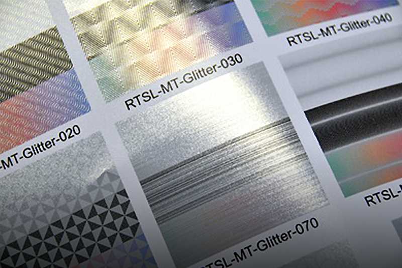

Yeah, I used to own a large format screen-printing shop where we printed a decent amount of metallics and fluorescents, it is just cost prohibitive to screen print short run decals. I keep seeing pics from Roland and Mimaki (like the ones attached), that piqued my interest, hence my original question. Thanks for the reply!
