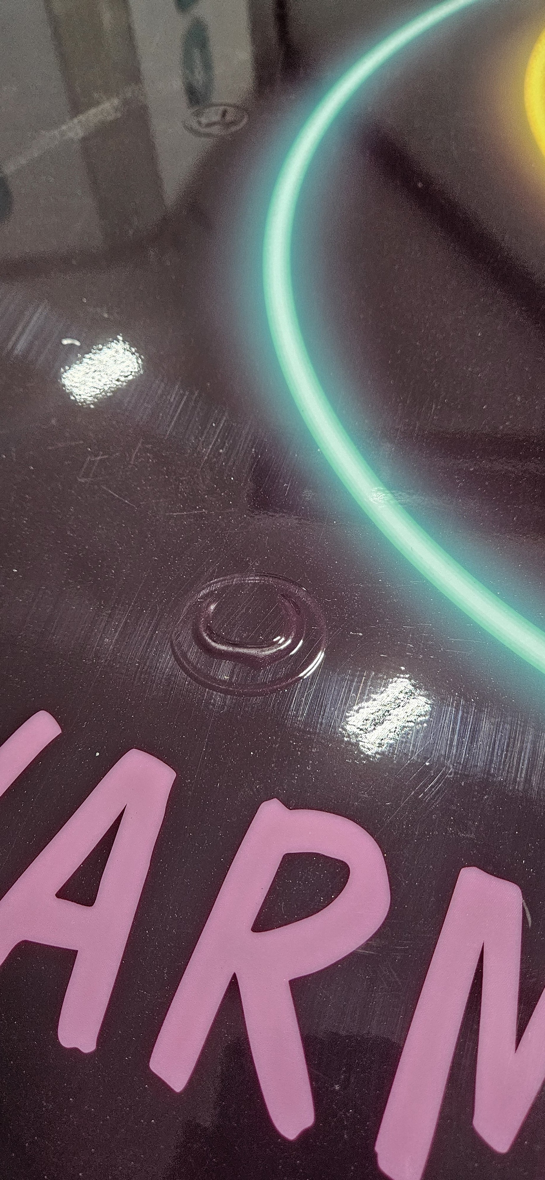

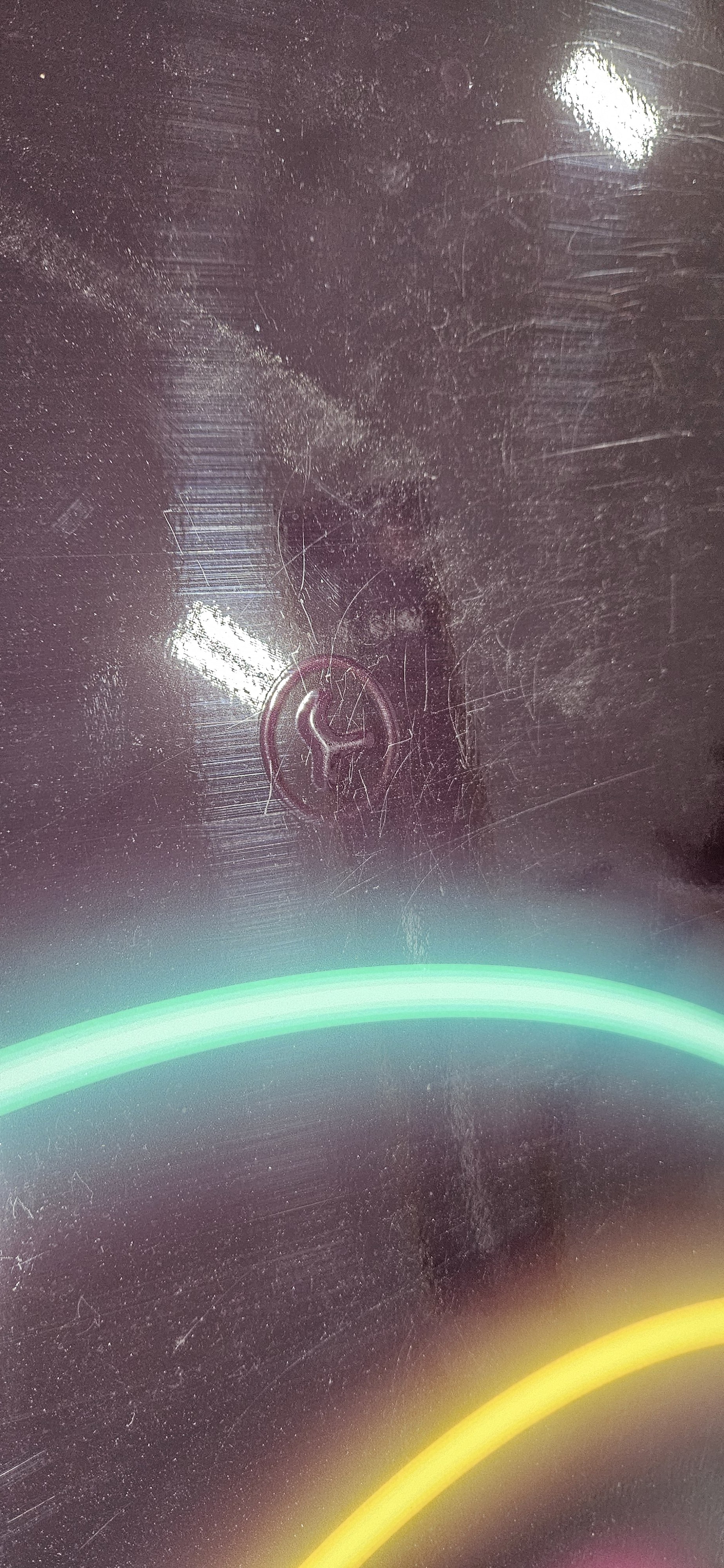

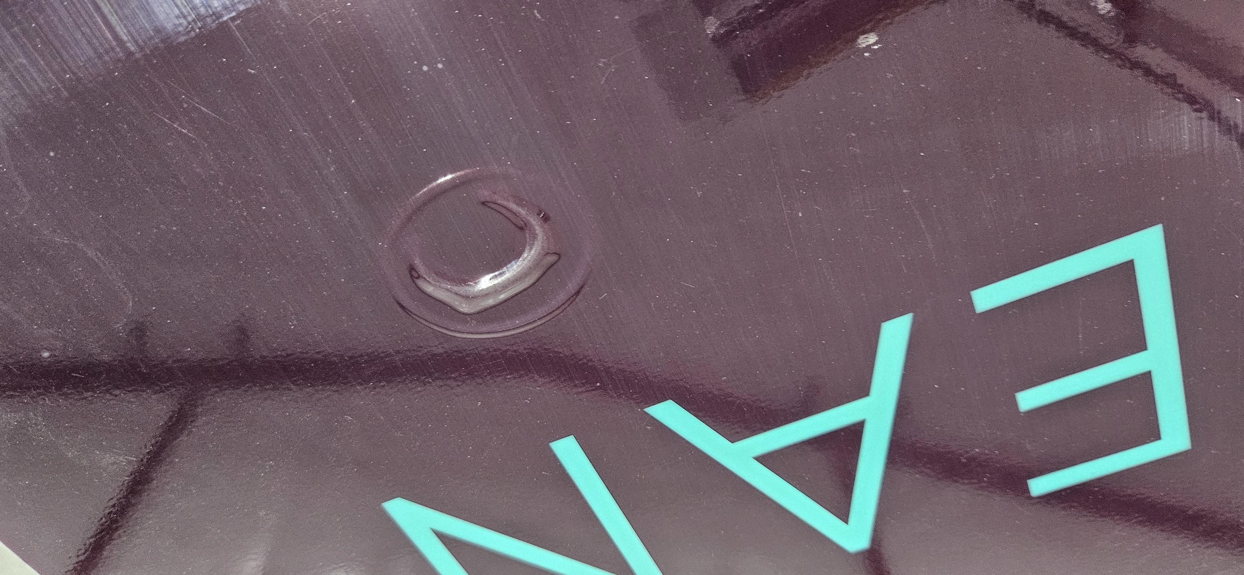

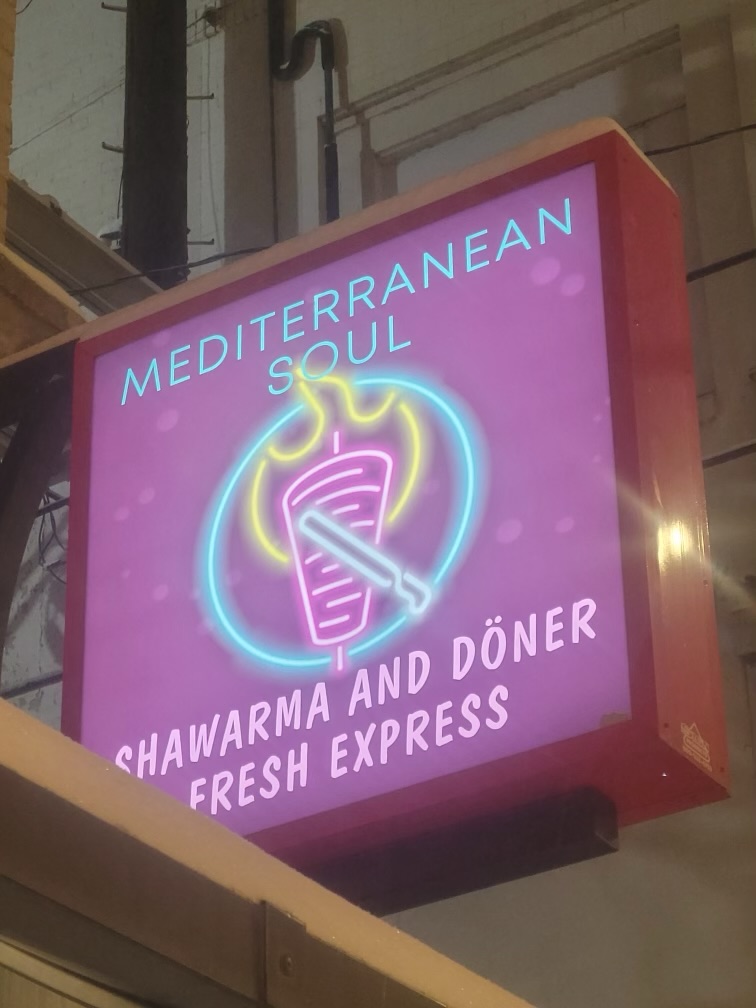

I am currently using 3M™ 40C-114R Clear with 8519 overlaminate for my translucent faces. I Have one sign that I know of with issues and it seems to be the side that gets the most sun. it causes pockets of bubbles. Does anyone have a better solution or what product works best for polycarbonate backlit faces? What does everyone else use? Using latex 335

Big fan of arlon 4500G CLEAR (ya gotta make sure it's spec'd as such, they make a translucent clear as well) for anything without an exposed edge, as it tends to shrink, paired with arlon 3420 satin laminate. Only potential problem is that this product has no air egress, it will need to be laid well or laid wet...

Do you think satin lam is better or go with gloss for better uv protection I meant to say I am using 8518lam. crazy how I have only had problem with one sign that I have done for this company. started to think it was something else. I told them to send me pictures of it when they take the face out.

We have experienced similar with polycarbonate faces in the past. There was moisture trapped in the poly and when heated up caused the vinyl to bubble. We had a whole batch of this poly we had to "bake out" in the sun for a few days before vinyl could be applied.
signheremd
Polycarbonate needs to off gas for 24-48 hours before you apply vinyl. Both DChorbowski and weyandsign are right. There is another similar thread from last year with lots of information, just look up bubbling vinyl on translucent faces.

Does that 3M vinyl have air release? We have found that you cannot use air release vinyl on polycarbonate for exterior signs. You will get numerous bubbles.

It does, and I suspected that to be part of the problem here.
