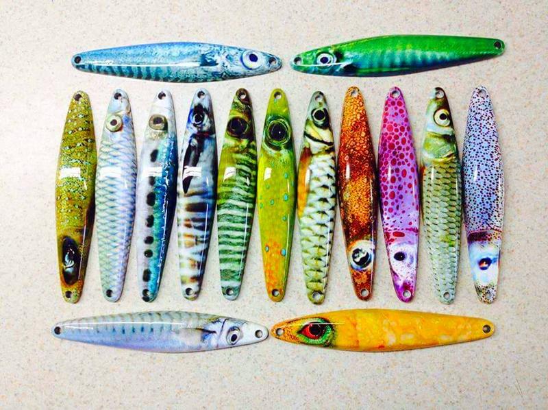

These aluminum and zinc jigs were powder coated and I have tried doing it with UV and it worked fine, I ended up doing 3D Sublimation instead because of the application but it should work fairly well.
