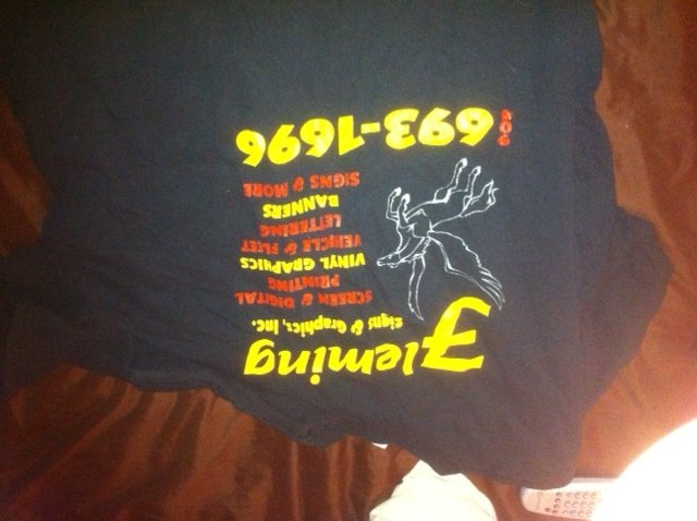

d fleming
13 year old shop shirt screen printed by a trainee on his first day. Used for yard work now.
