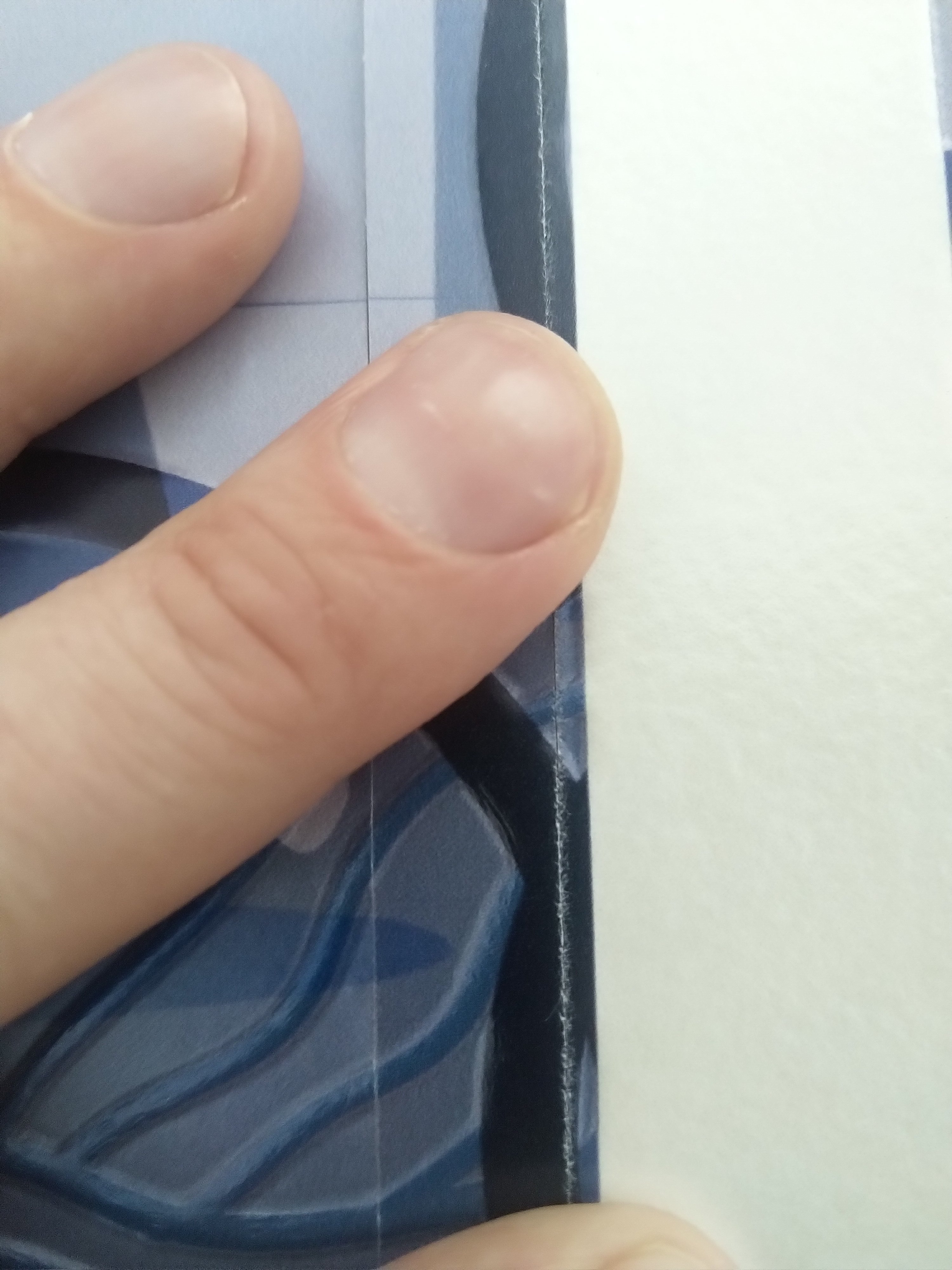

Has anyone had any successful experience with cutting Dimense wallpaper material? We have a manual cutting table as well as a Summa flatbed cutter and we have not managed to cut the material perfectly so that the seams are not visible when installing the product.

All the blades / modules we have used (double edge, kiss, burr free, etc) rip through the material rather than giving it a clean cut. The material is a non-woven backing with a spongy print (the dimensional print), therefore the blades rip through it so that leads to the edges being extremely jagged, so when putting it up the seams are visible and not acceptable for the client.
The other issue is the tension in the material, when cutting samples or even along the edges, it pops up which doesn't allow for an uninterrupted cutting process, we need to tape it constantly to the vacuum area.
I have added a screenshot to show the type of cuts (the right side is cut with summa - the best cut that we could manage, the left one is with a keencut manual rotary blade. The keencut cut (pardon the pun) is a lot cleaner, but the seams are still visible when installing it up a wall.

We trim flat non woven wallpaper on our 1612 using the kiss cut blade without issues. I’ve seen the “soft” Dimense prints and assumed you’d need to double cut at installation which is not ideal for DIY hanging. Have Dimense been able to offer any solution?

We have no issues with all our other non woven materials, however thick they get, it's just the Dimense material that's iffy because of its sponginess and tension in the material (this is a separate issue other than the visible seams, if you want to cut samples, you have to reset the cutter at each sample, the minute it cut a rectangle, it immediately pops up due to tension).
Dimense didn't offer a solution per se, they mentioned double cutting, but we avoid doing that at all our installations as it leads to other issues far worse than visible seams. We've tried double cutting it on our cutting table just so we can rule this out and regardless of the blade of choice, edges are jagged. What worries me more is that at FESPA, the Dimense booth looked beautiful from afar, but when you inspected it closely all seams were completely visible. You might get away with that with the structural (non printed) material since it's probably going to be painted over, but not with the other ones.
