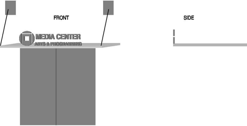

I have a customer that would like something like what I am attaching in the sample. They have a four piece logo and they want to have there name stacked. I have seen in Gemini that this would be possibly a combonation of Bottom Stud and possibly a rail installation. My main question is, has anyone on here done something like this? If so i'd really love to see a sample of the work, so I can best plan my attack on this one.

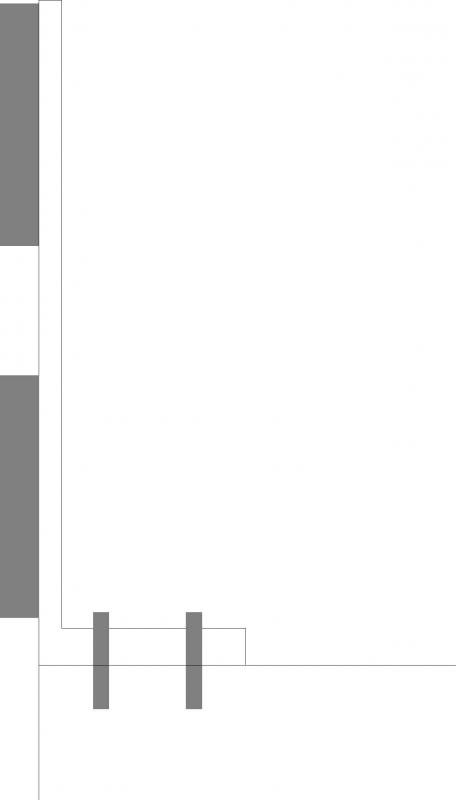

Ok, just got off the phone with Gemini, they suggested a plexi cut to the same shape and mounted. So I would get the effect the customer is looking for (floating) But my concern lies in the mounting and Install of the sign. I've already proposed these questions to them, but I am still looking for some feedback.
Thanks.
J Hill Designs
I was thinking a clear plex backer too - with a 90deg bend on the bottom to mount it to the awning thingy (technical term)

If this is exterior, plex will look like crap after a while...
I have done long stud mounting, but it's a pain in the butt.
Letters are looking a little small, Have you tried superimposing this on a photo to see if the lettering gets lost in the background?
Another thing you might try is a perforated metal... either squares or radius holes as a backer. Or a metal with a color/pattern combination. Pin the logotype and logo off the backer... Are you doing any illumination? Uplighting can make that pop at night if it needs illumination
