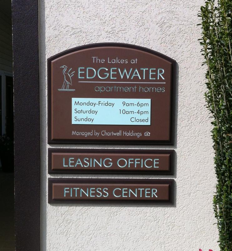

Along with Sherwin Williams, Matthews Paint is also another good choice. Biggest concern with PVC is dark colors and size/thickness ratio with regards to expansion/contraction issues. It's a learning process that takes some time to figure out.
Pvc will take any good quality acrylic paint just scuff it with 220 grit sand paper and wipe it with alcohol. Here is example of two layers of pvc 0.75 and 0.5
