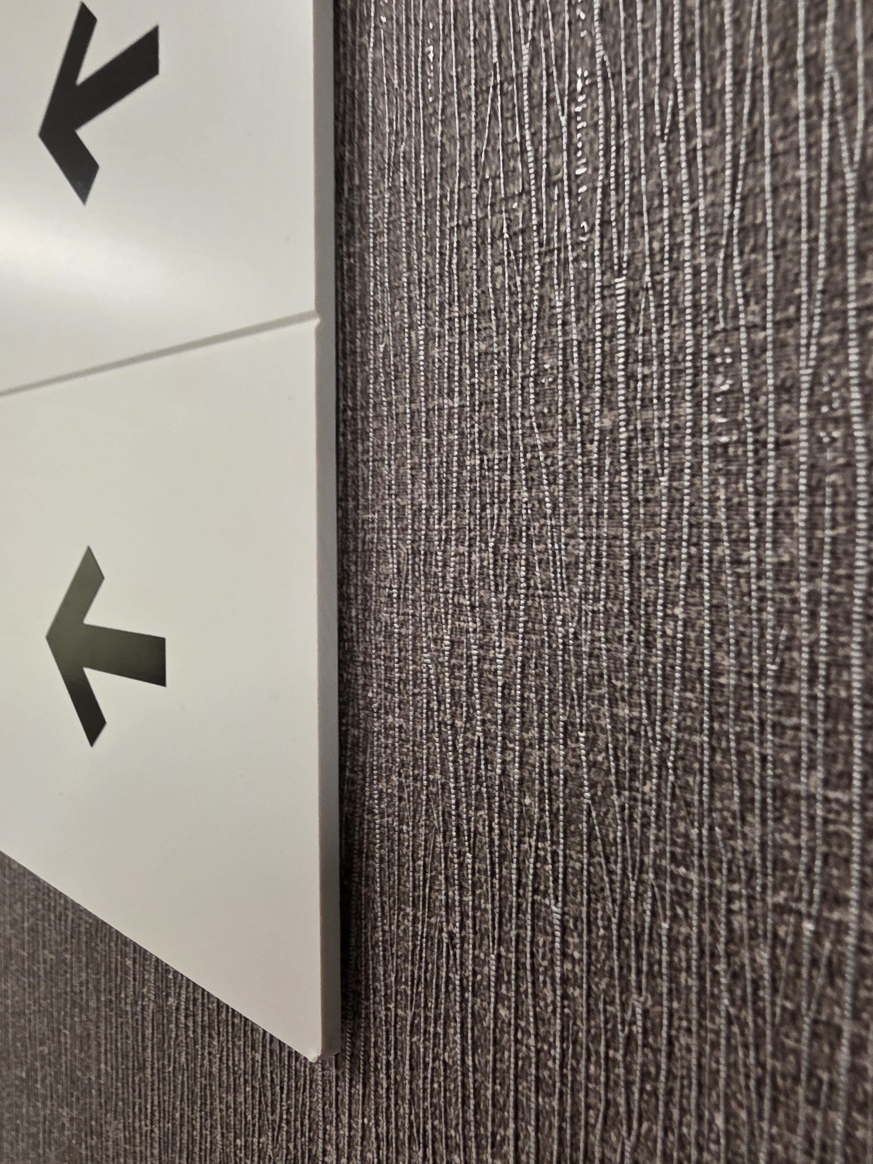

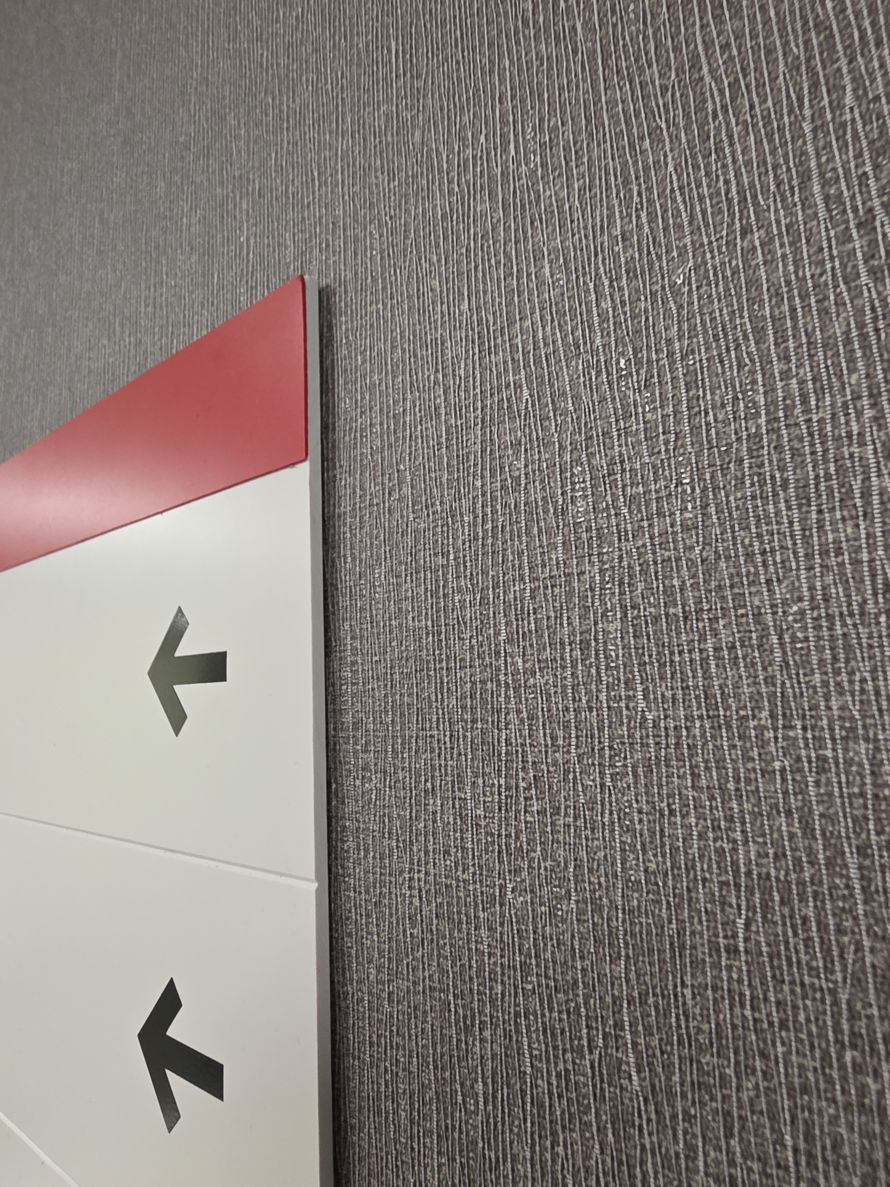

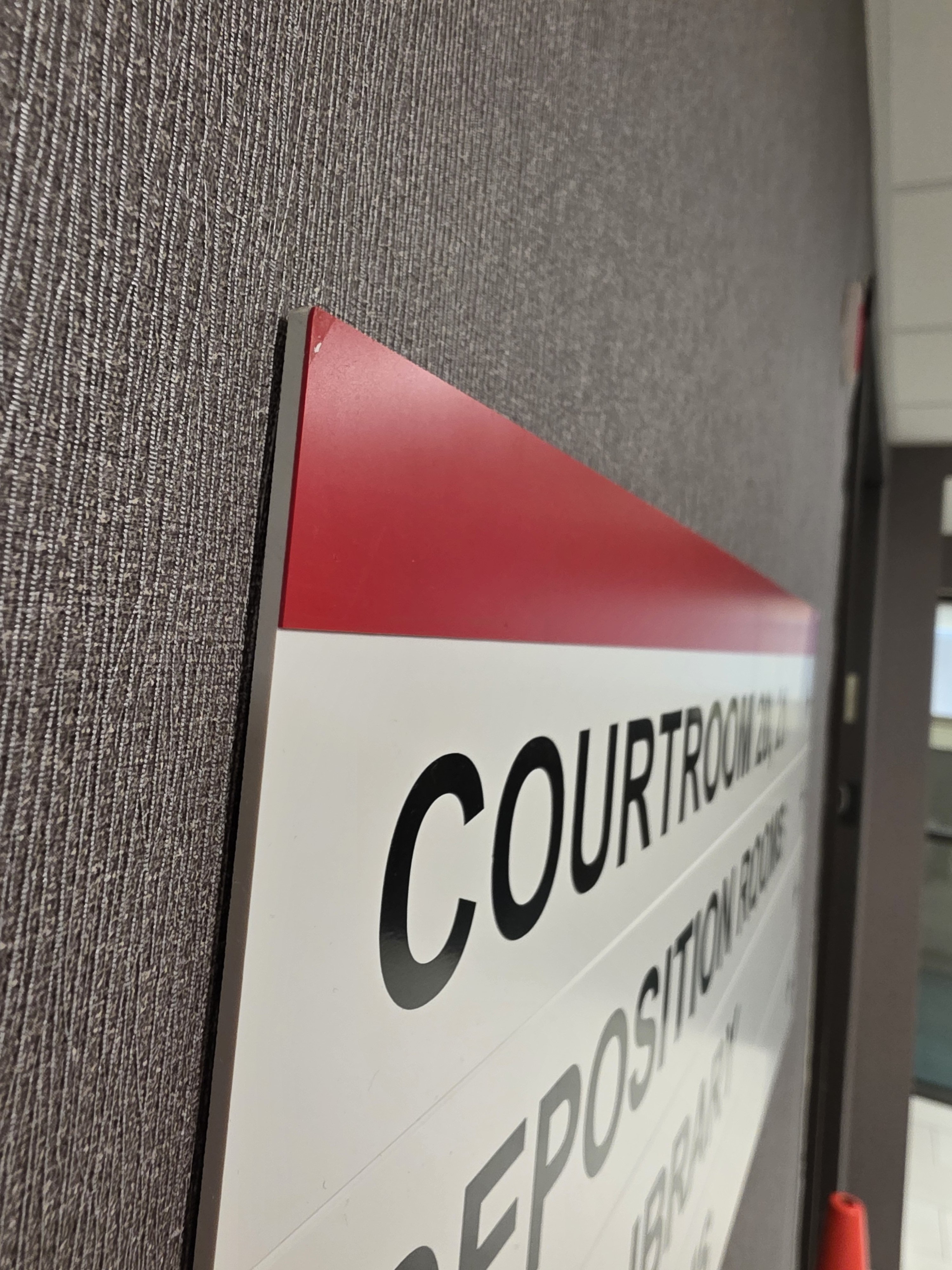

I have a customer that's looking to match their newest directories from ~4 years ago.
The substrate has "ridges"? ~ every 3" and is about 30" wide.
They have some that are 3 "panels" high and up to 8 "panels". I'm referring to the space between the ridges as a panel.
Have any of you seen this type of material anywhere? They want pricing to just add a new "panel" to some of them, and then pricing to completely replace old directories on some floors.
I'm just trying to find out where I can get it so I can lock down the pricing for them.
Thanks for you help.

johnson plastics plus sells good ada material, but sizes are limited to 2'x4' @ 1/8" thick. Depending on thickness, this may be white pvc, with red ada material on top.

I usually get the Rowmark or Trotec ADA material. I've just never seen this material that has the ridges in it. It doesn't go all the way through the material.
The large red rule doesn't look like vinyl. It looks like a thinner thickness of the same material adhered to the backer. I think you'll need to figure out how the whole thing was fastened to the wall. I don't see any fasteners, but if that whole sign is pvc or some variation of that, it's going to be heavy. I doubt tape will hold it to a straw wall. Will you be responsible for fixing that red corner area ??

Looks like expanded pvc for both colors. Red 1mil (1/16")for the header and white 6mil (1/4") for the body. Definitely been routed across with a v bit. Its cool what you can do with the right tools and imagination. Good luck

i think you're right they're both the same material they have the same sheen
Thanks for everything. None of my local suppliers carry the colored pvc (sintra/komatex). I'll try and mock something up to see if I can switch materials, or do something besides the V groove to separate the panels.

also last mention, depending on what you choose, don't pick a material that is soft so when you go to change the vinyl on the directory you don't gouge the material by accident
