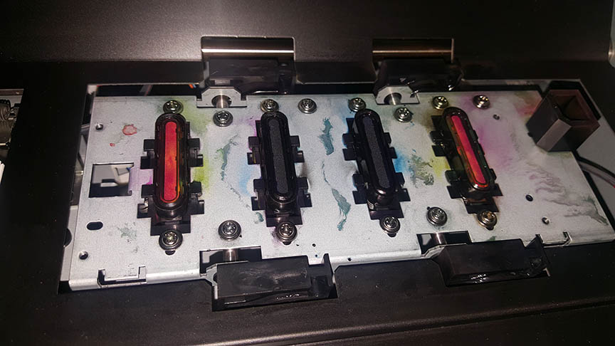

Hello everyone, Im looking for ideas on what would cause the captop area to begin looking like the photo. this machine gets cleaned manually every Monday. the area around the captops used to be just slightly dirty with a mist of ink on occasion but it seems to have gotten alot worse the last 2 week. the print heads themselves are no where near this dirty.
Roland Truevis vg-540 2x CMYK
Thanks in advance!

Are you talking about the ink waves on the sides?? That is static from my experience. Fine ink particals getting moved around by staic.

also double check to make sure your machine is docking correctly. the ink caps could be getting worn leaving little gaps in them allowing extra ink to escape.
check the sensors make sure they are clean and not out of alignment.

sorry about that, yes im referring to the ink waves around the captops.ill check on how they seat here shortly

Papabud and Petepaz are right, the problem could be caused by static and/or failing cap tops. You need to replace the caps and control static better. Call your dealer for cap top service and, for static, check out our published guide here: http://support.rolanddga.com/docs/D...es/Static Suppression for Roland Printers.pdf. (Don't forget to check other causes, such as humidity around the printer, not just the room temp)
