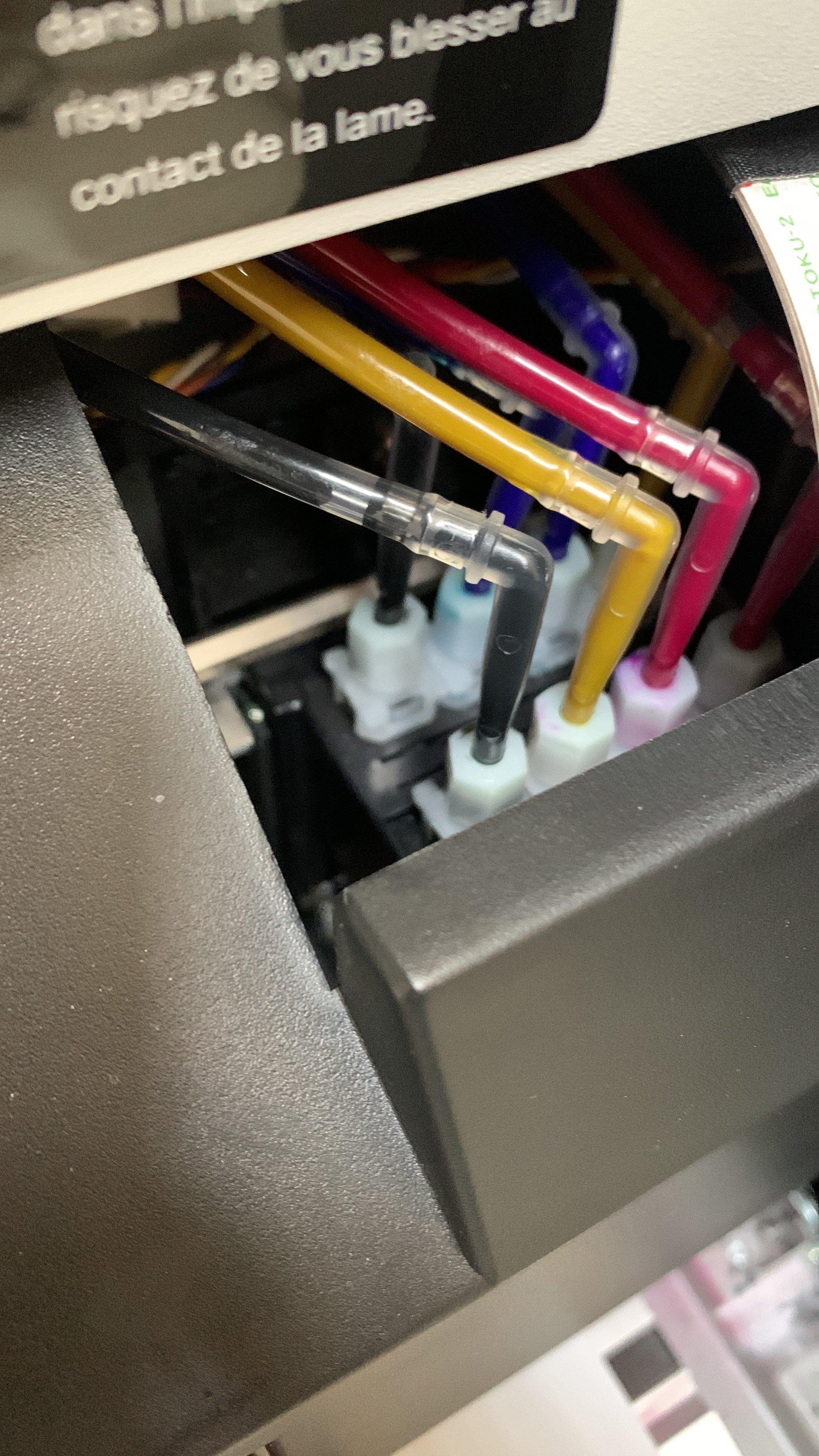

I want the machine back at least as it printed before but now the damage is done and I'll take it in that place. Look the picture (black and magenta) and say me if this is normal... Before there weren't these shortcomings

I'd pull the tube off the black channel and see if you can pull ink through it with a syringe. From the photo the black looks like it has dried up and blocked the line.
If you can pull the black ink through and still not get the black to print, you can switch the black line to one of the other channels that you know are good, and then run a few cleaning cycles and then some nozzle tests.
If the problem follows the ink line (still no black) then the issue is up the tube to the ink cart. If the original black channel is not printing the switched color - try switching the damper over. If nothing changes the head could be bad.
