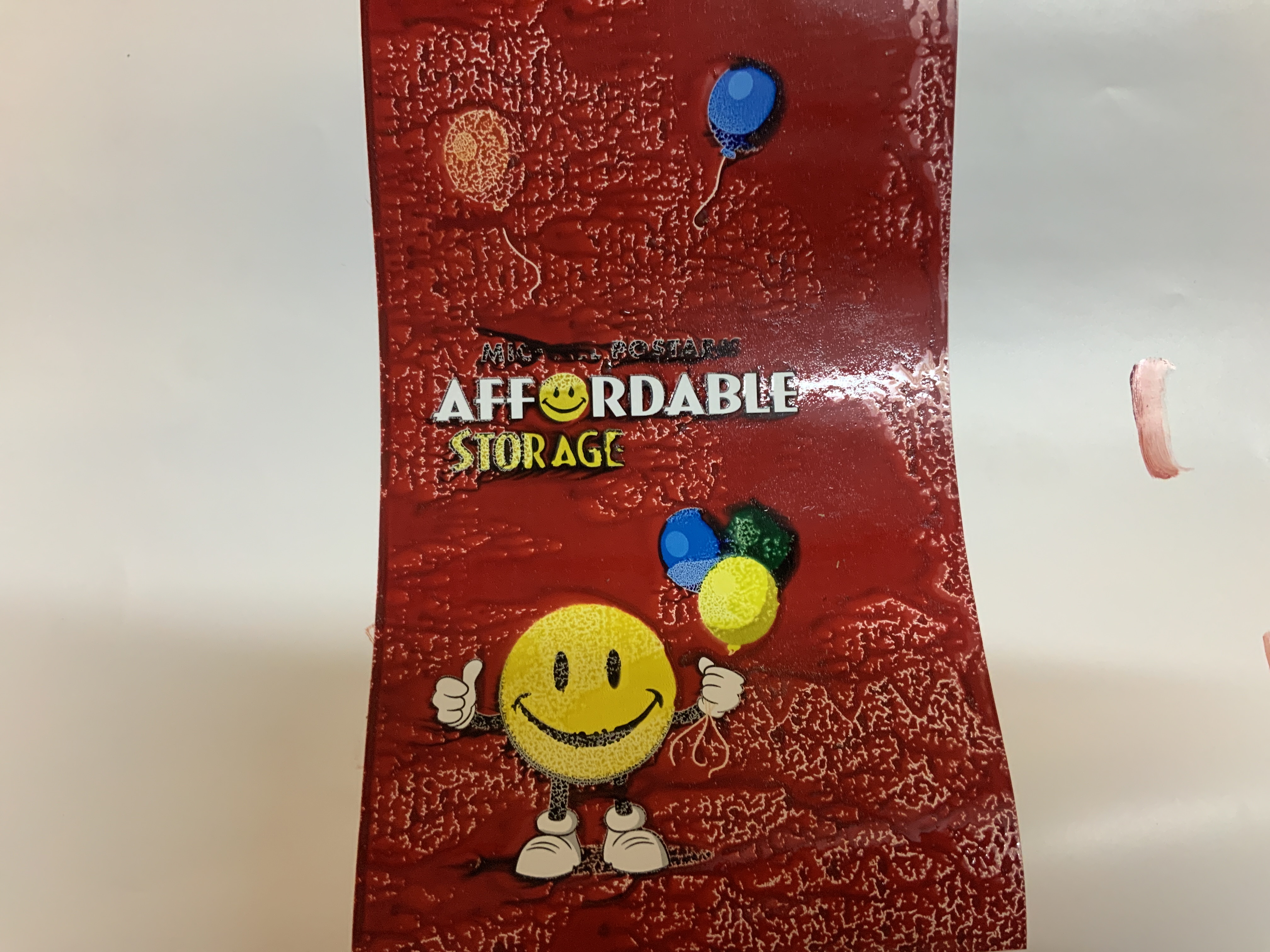

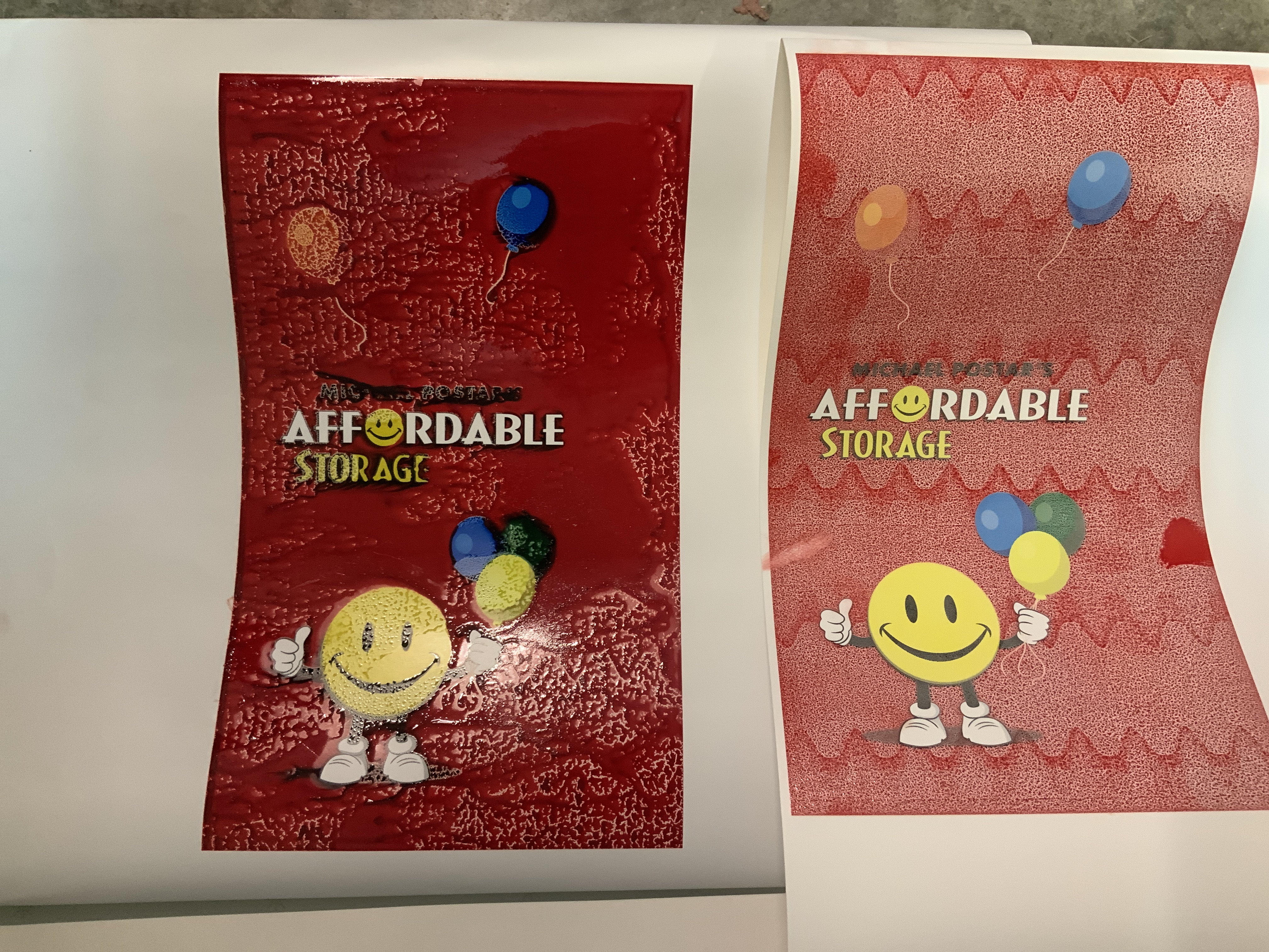

Need help trying to solve this print issue I’m having with ij35c-20 3m material.
First time using it and I keep getting the print doting on the red.
Just need help figuring this out. Newbi here.
Printer is l26500, the material feels waxy where The ink doesn’t stick.
first picture
drying temp. 130
Curing temp 230
second
Drying temp 130
Curing temp 190
Setting for both.
2bpp, 8 pass, low ink, 40 speed.
heat flow 30%

Would recommend 10pass curing temp seems high on the first round. Would recommend higher ink density as well. Did you get a 3M profile or are you using a generic profile?
jimmmi
Plasticizer problem. Try wiping with alcohol the half width and reprint all width. If the wiped is fine then plasticizer will confirmed for sure.
