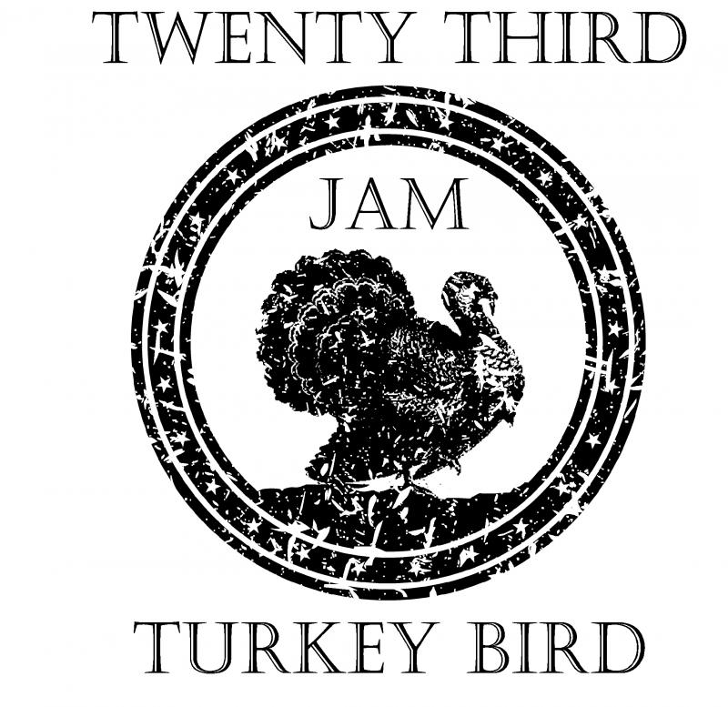

Here's what I do:
Figure out what "look" I'm going for
Google Image search cracked or speckled what have you
Convert the pic I find to black and white
Vectorize autotrace it
Scale it to the desired size and place it over the image
Like this

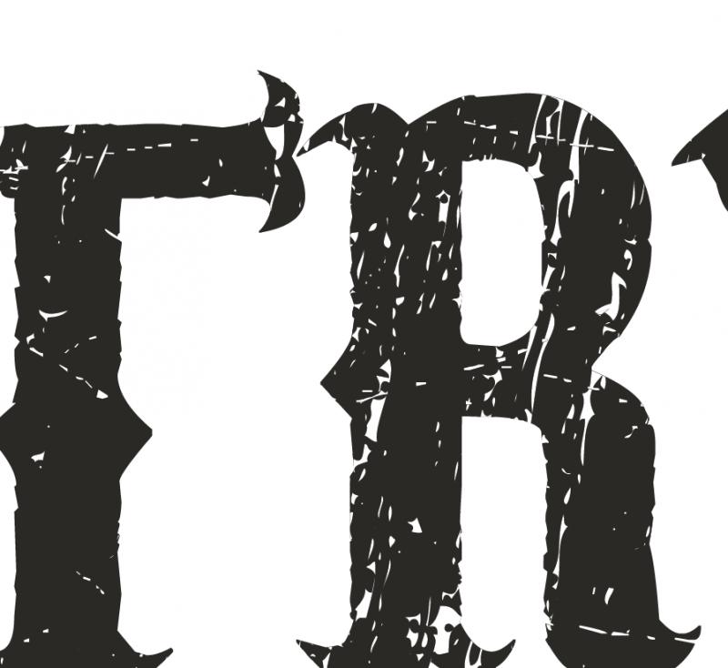

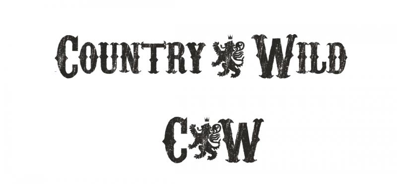

as TSGSTL said, I have a couple free "grunge" or "distressed" vectors that I probably got from vecteezy and I just lay them over top. If it is going over somthing else, I contain the grunge element in a clipping path of the same shape it is covering.
