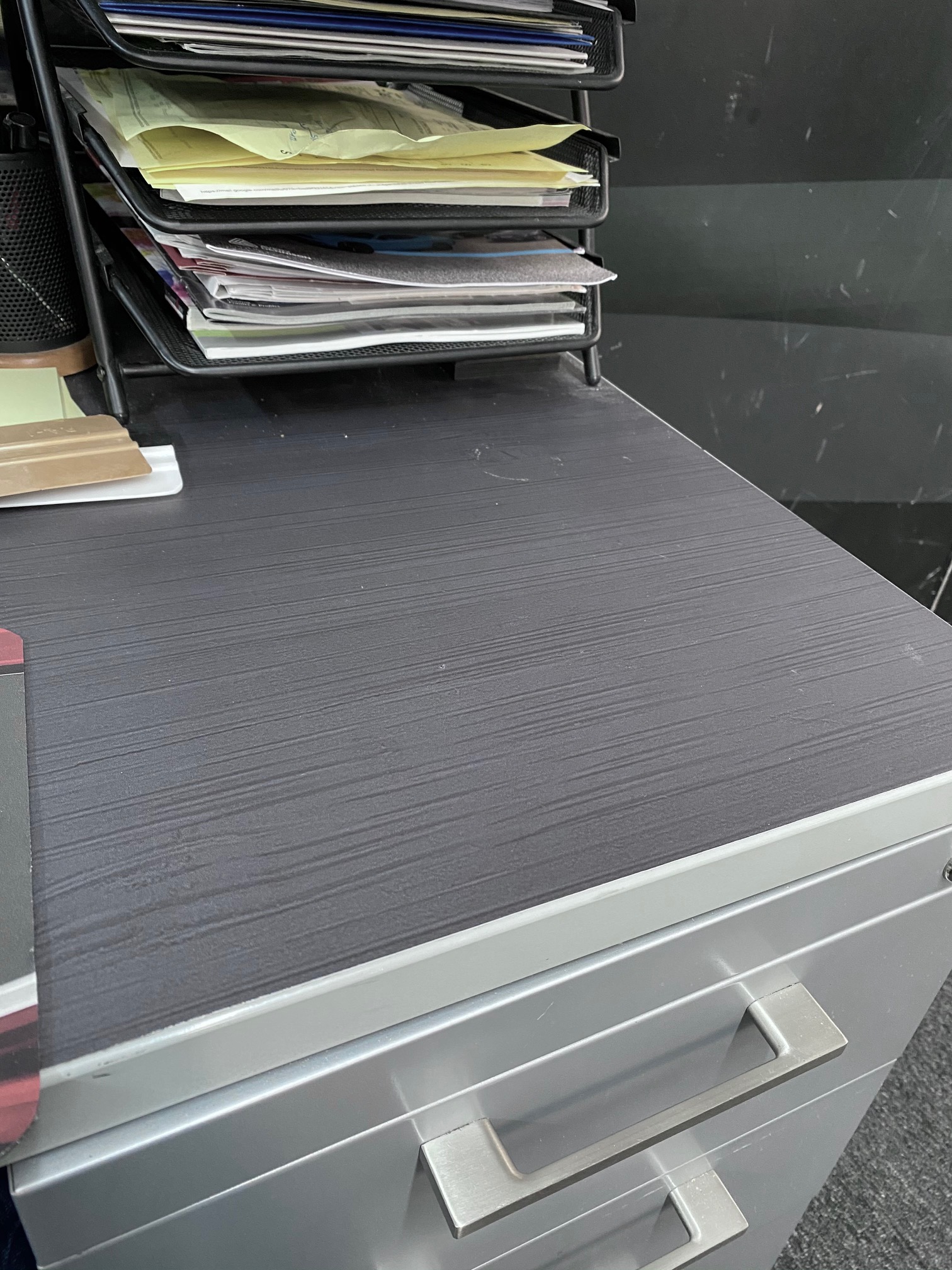

I did just this for the tops of all our desks in the shop.
That looks awesome. What media/lam did you use? I wrapped one of our desks 5+ years ago with IJ180cv3 + 10mil lustex. Still looks like the day I installed it.
