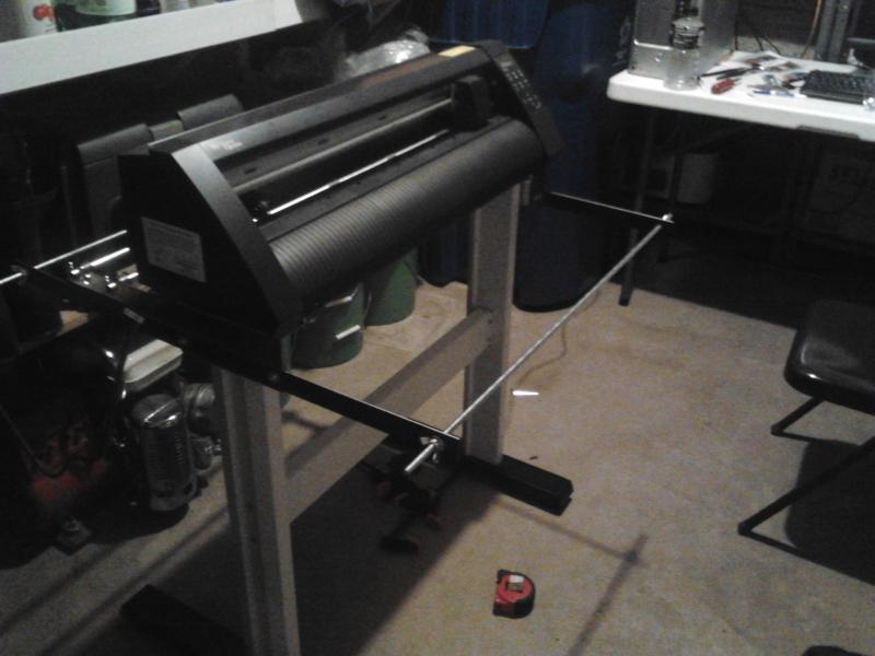

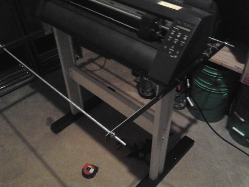

yeah i went a little more extensive than that. just got the machine recently and wanted it to look as factory as possible.
i used:
2 pieces of 1/8" flat steel(4 holes drilled in it, 1 at each end, 2 in the middle to mount to factory holes)
2 pieces 3/8" threaded rod(being covered by pvc to prevent from wrecking material)
4 3/8" wingnuts(one at each corner, so i can remove fabric when needed)
2 yards of fabric(getting it sewn, will have it back friday)
excess flat steel and threaded rod have been cut off as well...
when fabric is back, i will post pictures. everything is also being painted black.\
maybe cost $30.00 for everything, and turned out really good!

thanks CS. definately saved alot of money compared to the Graphtec ones. and yeah, its VERY sturdy. no flex to it. just wanna get the fabric on, and see how it goes.
