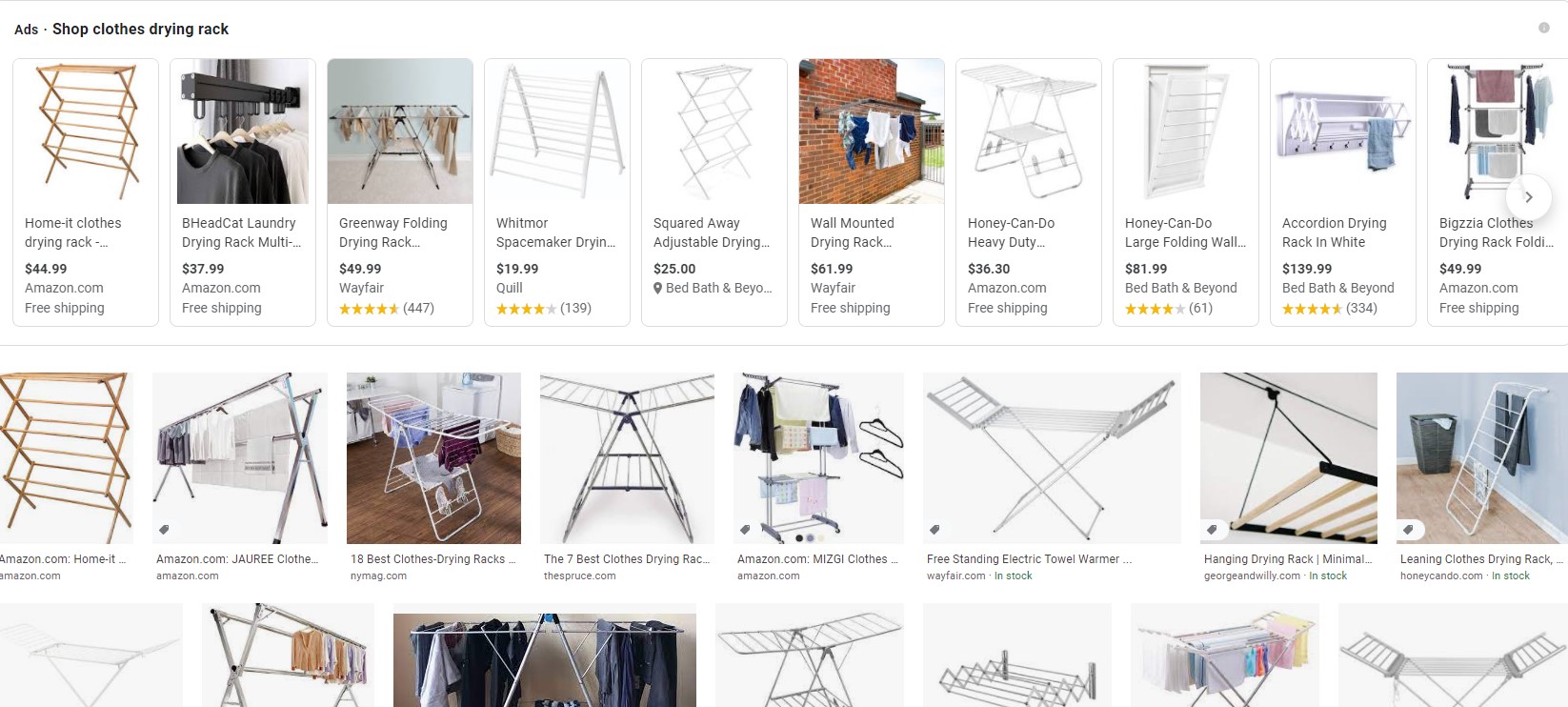

what about a clothes drying rack? or at least might give you some ideas for construction of one
Pauly
Printrade.com.au
Something like this?
We use something similar for glass. Except ours are double sided and padded. We made ours, but im sure some fab shop can put one together very easily.
